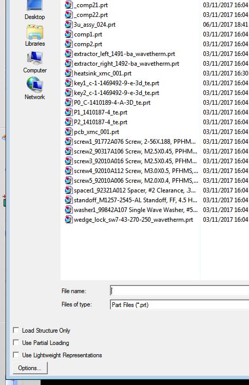

If I load an Assembly with a suppressed omponent
with the load option partial loading unchecked.
Do the suppressed component will be loaded ?
Thank you in advanced.

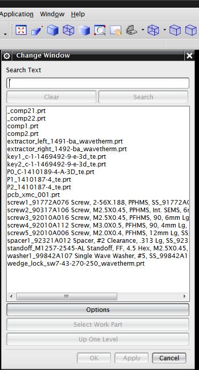

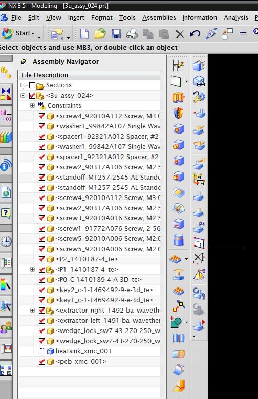

RE: Load assembly with a suppressed component question
Hi Tomas
If you see this
I do a test and suppressed component in blue
not apeare that it dose not lodede as the pictures show.
Thanks.
I thinks it should be as you said.
but I don't know why I don't see it
in my test example.
I played around to find something NOTHING.
I tryst many load options combinations and nothing works.
I'm writing a journal that conceptually need
to load a whole Assembly and the journal
has access to the load options functionality only.
Do someone have an idea how to do that.
