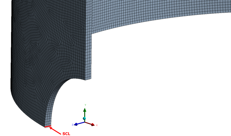

MrPDes, the problem that I have shown here is a very famous problem in the theory of elasticity. It shows that for sufficiently wide plates -with a hole in center- that are subject to a unidirectional stress field, the stress concentration factor is 3. As you have mentioned the stress can be considered to be peak stress since it is developed due to stress concentration. However, if you consider a through thickness SCL just at the edge of the hole (perpendicular to the drawing plane) the average stress will be almost 3σ. This may lead to the conclusion that since the average value of stress over the SCL is 3σ then this is the membrane stress.
TGS4, as you have guessed I am talking about the appropriate location of an SCL. You say in this specific case the SCL perpendicular to the screen is not appropriate. Then you change the SCL direction from the edge of the hole to the edge of plate. This is a very simple case and you can simply choose another path to exclude the peak stress effect on membrane stress. However, in a more complicated case (like the vicinity of a nozzle edge in a cylindrical shell) it will be no longer an easy job to do.
TGS4 suppose that instead of a flat plate, a cylinder with a hole is considered with a uniform axial stress. What will be the appropriate SCL then? This time it cannot be a line that comes from the hole edge and goes in the hoop direction.

Please draw a sketch with some proposals for an SCL, and I'll provide some feedback.
RE: Excluding Peak Stresses From FEA Results
TGS4, below is a sketch of what I mentioned in previous post. The SCL that I have shown (to my eyes) seems to be the only acceptable one in order to evaluate the state of stress at the edge of the hole. If the average of stress component in Y-direction over this SCL is considered as the membrane stress then the effect of stress concentration on this average value is neglected.

Paulettea,
There would be no need to produce an SCL and conduct linearization at the location you have shown, because there is no bending stress or peak stress. There is only a 'local' membrane stress Pl which is limited to 1.5×(Sy/1.5) = Sy.
Away from the hole is the General membrane stress Pm which is limited to Sy/1.5.
The hole has the effect of intensifying the membrane stress, for which the stress intensity factor would be Pl / Pm. This particular example of a stress intensity does not contain any peak stress or bending stress. It is purely membrane. The hole would need to have a nozzle neck or something similar to produce bending or peak stress.
If this local membrane stress at the edge of the hole exceeds its allowable, then reinforcement needs to be added in the form of a thicker shell, reinforcing pad etc.
Also, the greatest local membrane stress would occur at the other corner shown on your FEM model (90° around the hole), where the hoop stress would cause the SCF to approximately double in value compared to where the SCL is currently shown.

I'm not entirely certain that I would categorize the membrane stress in that perforation (an isolated hole as such would typically only exist in a perforated shell) as primary local. Depends on the loading. Depends on a lot of things.
When in doubt as to the appropriate categorization, refer to 5.2.1.2.

MrPDes, the cylinder that I modeled is not a pressurized one, I mentioned earlier that it is just under a uniform axial load. Suppose the cylinder is long and the hole is just at the middle of the shell. That is why I considered the SCL at that location. But I agree that if t was a pressurized cylinder the SCL has to rotate 90 degrees. From what you have said I come to this conclusion:
If the increase in the stress is due to discontinuity then the membrane stress obtained from linearization is local membrane stress. And the stress due to nonlinear distribution over an SCL is peak stress.
Therefore, in order to exclude peak stresses I do not need to know anything about the source of stress and just stress linearization is enough.

I think that if you linearise across your shown SCL the result will be a total stress shown as a horizontal straight line. This would indicate a local membrane stress of same value as total stress, a bending stress of zero and a peak stress of zero.
The conclusion is that with experience you would know that there was no need to linearise (Of course it is nice to check just in case something unpredictable shows up). Perhaps there would be a small amount of radial distortion causing a small amount of bending, however there are no sharp inside corners to produce peak stresses.
Your example doesn't produce pressure vessel type stresses so as per TGS4's advise, you might want to refer to 5.2.1.2.
Perhaps you should read Annex 5-A which has allot of information relating to your questions.
The answer to your final question is included in 5-A.3(a). I suspect that you need to research and gain experience learning the difference between plastic collapse and local failure and how each of these failure mode relates to the size and nature of a particular discontinuity. With experience a pattern will begin to emerge.
