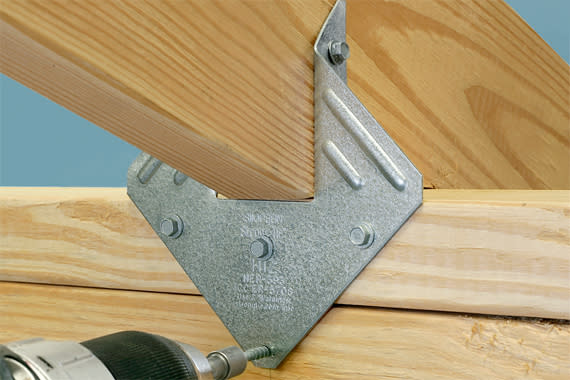

The pic below is, of course, of a rafter connected to a wall. Suspend disbelief for a moment, however, and imagine that you're instead looking down upon your ledger board with the wall studs running out of the page. This solves another issue as well. It gives you a legitimate path for transferring your roof diaphragm shears out to the exterior wall sheathing where they belong.
