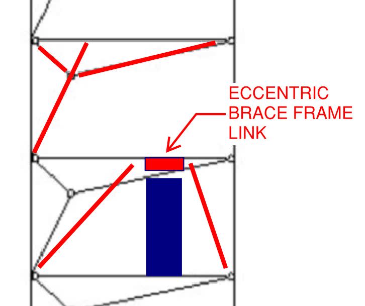

Yeah, the demand for WSE's fourth brace would seem to be the issue. And it's hard to imagine that you'd get such a brace. Here are some wacky alternatives. If you're high seismic, it's a different conversation of course.
RE: Portal Bracing
Yes those were my thoughts as well. That first one KootK drew up is what I was thinking of doing. Looks like it’s ny best option, I don’t really have enough room on the opposite side of the door to Run a brace on that side.

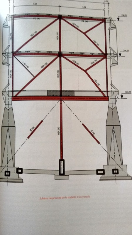

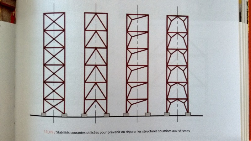

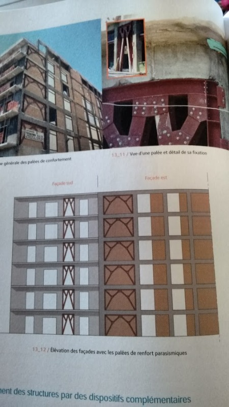

I agree that for compression forces that central node just buckles sideways but this bracing system may carry tension forces if loaded from left to right (in your sketch). If you have other systems in your building that may carry horizontal loads coming from the other side, thys system might be feasible, albeit not as stiff as a typical diagonal bracing.
I've seen these systems in an excellent french rehabilitation book ("Guide de la rehabilitation avec l'acier" - Link). Here are some photos I took of a few pages which show this system applied in the context of rehabilitation:

I see this type of bracing used for crane systems quite often as well. But it's usually a double sided entity like shown on the last attachment by avscorreia

There's no need to extend the sloped vertical member to the beam... just complicates things.
Dik
RE: Portal Bracing
Quote (dik)
It does complicate things but there is a need. The need is to supply out of plane stability to a C-C-C joint. There are other ways but that was the intent of that option.
