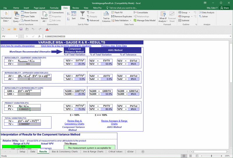

Here is a sample MSA GR&R, not from the machines in question.
RE: GR&R impact on pass/fail tolerance

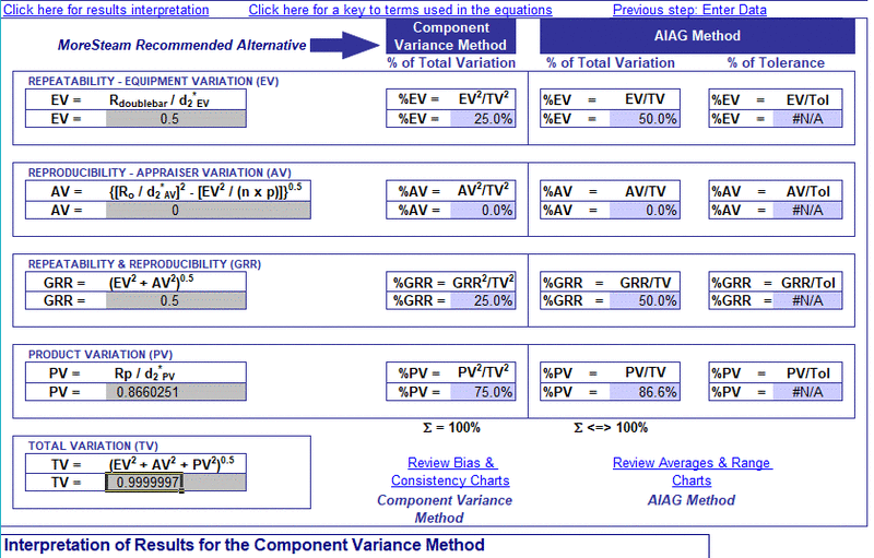

Are you using the AIAG method or compound variance method? This spreadsheet, specifically the "Results" tab, can be used to backsolve for the reduction in PV that would be allowed, given whatever EV you have.
Below are the baseline case and the solver case to meet a tighter acceptance criteria. Using compound variance, the net variance would need to be tightened to 86.67% of 5%, so 4.33%

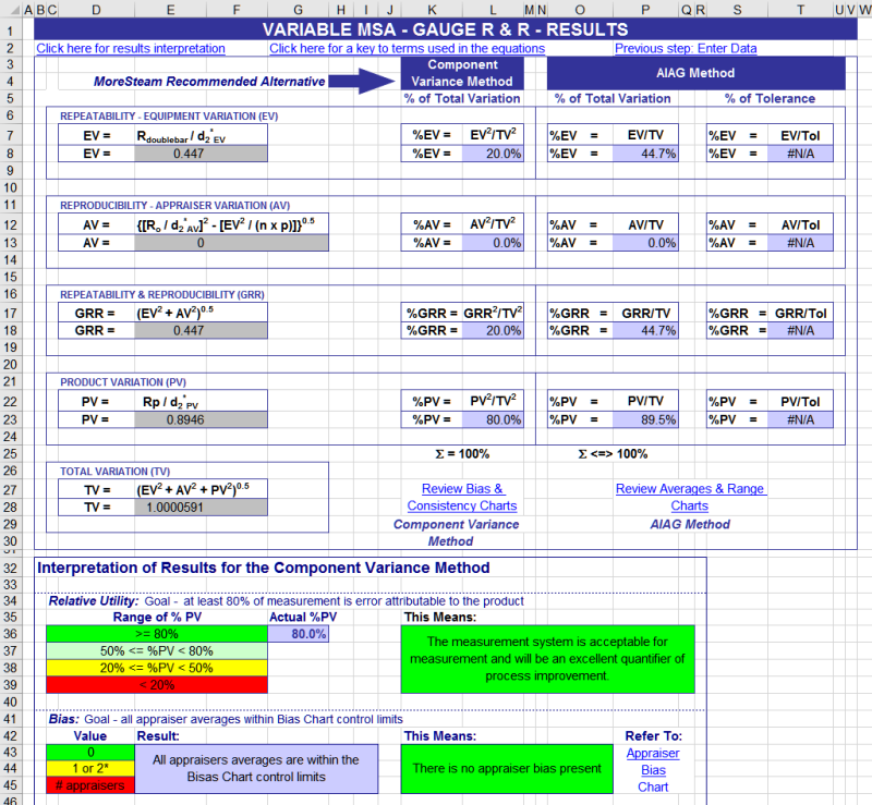

Thanks for that spreadsheet. I'm not quite following what you did on the Results tab. It looks like you entered 0.5 in cell E8 & E18 and 0.866 in cell E23 to drive the output in E28 to 1. Is that correct? Where did the E8 value of 0.5 come form? That is showing GR&R of 25% in cell L18. In my case the production equipment has a GR&R of 20% so should the input to E8 & E18 be 0.447 which gives 20% in L18 and 0.8946 in E23 resulting in TV of 1.00006?
Then the process limits become 0.8946 * 5% = 4.473%

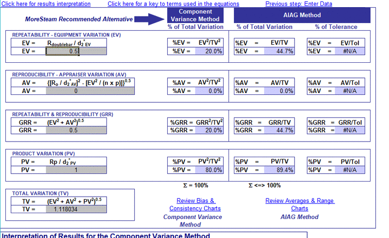

Sorry about the upload confusion. By now it should be pretty evident that I'm noob on the subject; nevertheless, it is a math problem and therefore interesting.
So here, I've got %EV at 20% of TV, by making EV=0.5, which is what I think your OP stated, where I basically put PV at unity and assumed there was no AV (operator error).
So that puts the TV larger than the allowable spread. The second sheet basically uses Solver to set the TV=1 by adjusting PV. I'm unclear whether this is what you intended, though
OK, I see what you did in the first screen, but why would you not just use the reciprocal of the TV=1.118? That gives 0.994, which is pretty much want I came up with. Your second screen the GR&R is now 25%. I must be missing something.
The GRR gets larger because the the TV has to decrease to fit the spec. Since that comes at the expense of throwing away otherwise good product, the GRR has to get larger.
To recap, your TV is an RSS of the 3 major components of variability, one of which (AV) is assumed to be zero, since it's an instrument and not an actual gage. The EV, based on the original statement of GRR=20%, is essentially 1/2 as large as the entire PV. If EV were zero, then all of the product would be acceptable at its specified limits. Luckily, you're RSS'ing everything, but, as it stands, the EV is potentially hurting you by potentially passing bad product as good, and failing good product. Assuming that you want to minimize the acceptance of bad product means that you'll now have to throw away good product, so that can only happen if you reduce the acceptance limits from the original 5% to ~4.3%. Since the EV is unchanged, the GRR winds up being larger, since its relative magnitude is now 0.5/0.866 = ~58% as big as the PV.
I believe that is correct, it makes sense to me. Thanks for the help. MFG is not going to like +/-4.33%, it's a little more than the +/-4.20% I was allowing but not the +/-4.8% they have been arguing for (+/-[1-.2^2]*5%).
