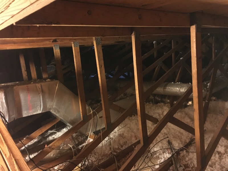

OK....the truss is actually slightly different than I described above. I believe the base truss, as dhengr notes, is a simple common truss that is ~30 ft long. The additional 15 ft horizontal top "chords" are actually supported with a vertical member at ~11 ft span from the center of the truss as shown in the photo below.
RE: Determining Maximum Load for Flat Roof for Solar Panel Installation
My lord that is an ugly set up now that we see more pictures of it. Those verticals that support the 2x4 framing don't even line up on a truss panel point. Scary proposition.
You need to have someone come out, review and measure the framing, and analyze the structure as built to determine the capacity.

jayrod12-
This house was built (and untold thousands like it around here) by a giant builder of the day (Reutenberg/US Homes). They even provided a big heavy brass plaque to the new homeowners upon completion! So, it must have been good. LOL
In seriousness, we can be sure that this met the code requirements of the day considering whom it was built by (and empirically, this house has seen 100+ mph winds more than once without any uplift issues at all), and I also have 12 pool heating solar panels (each is about 50 sq ft and full of water) on another section of the roof and there are no issues with that (they have been through hurricanes as well) so funky as all this is, it was someones good idea at one time and seems to work smile
Unfortunately, the fact that it is non something I can look up in an online table or otherwise reasonably estimate, means it may have overly complicated my solar pursuits sad
