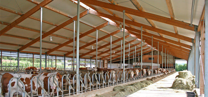

I'm designing a barn and investor wants the same barn look/bearing system as Wolf System has.
For those who are not familiar with it:

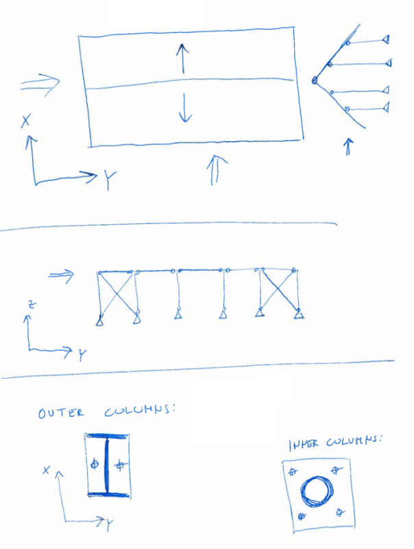

All columns are steel columns, they are all pinned at support and they support primary timber beams. Outer steel columns are IPE 270 sections and inner columns are circular cross sections. Primary timber beams as glued – laminated timber section that are supported on steel columns. Secondary timber beams on top of primary beams (biaxial bending). Light roofing on top of secondary beams.
Bearing system : inner steel columns supports primary timber beams and are loaded with axial forces only (compression). They are pinned at supports (RC wall, foundation or slab).
What I do not understand is how is this construction laterally stable in transverse direction?
In Y (longitudinal) direction I see no problem since there are X bracings between outer columns (2 or more vertical fields between columns are braced). Bracing between two outer columns also continue into roof planes. Since columns are connected at the top with roof I can see how lateral force in longitudinal way is transfered to X bracing which made structure stable in this direction.
But how the hell is structure stable in X (transverse) direction? At first I thought that all outer steel columns are fixed at supports so they act as cantilevers. But I saw an anchoring detail and its clear they are also pinned at supports. So we have all columns pinned at the bottom. In order to achieve stability in X direction the connection between columns and primary timber beams has to be a moment connection!? Right? I dont see how is this possible tho…
Both outer sides of barn (walls) are made as timber trusses which are lateraly stable in this direction (X direction), so if there would be a diaphragm in a roof system that could mean that whole transverse lateral force can get transfered to outer walls of barns, but there are no such thing in a roof plane (no sheating - dont mind first photo bellow).

RE: Help me to understand a bearing system of this barn

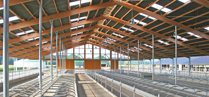

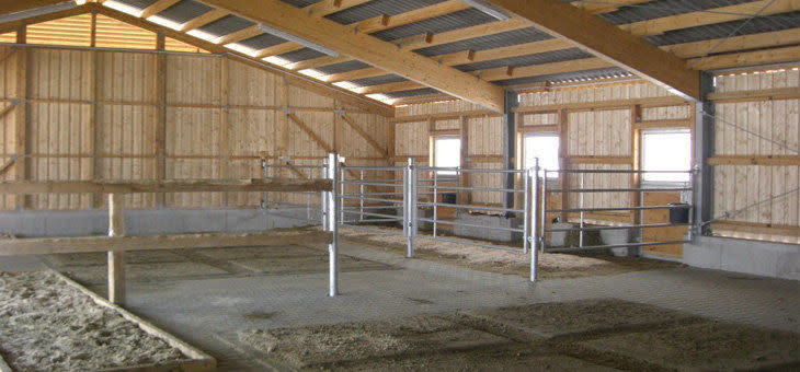

pics on their website they show some cable or rod bracing. I think the last picture you can see in the first bay.
It seems that someone is counting on some fixity in the wide flange base.

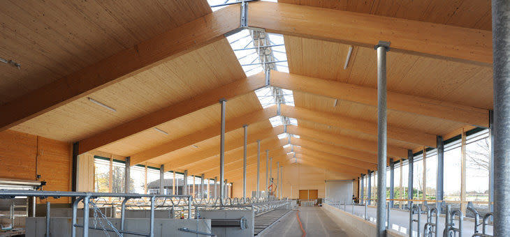

Looking at the connection between the IPE column and the glu-lam beam, I would venture a guess they're also treating that as a moment resisting connection. long plates onto the flanges of the glu-lam would generate some fixity.
I vote moment connections at the beam column joint. It can be done and looks as though it has been here. Maybe base fixity too, hard to tell. One way or another, transverse moment frames of some kind seems to be the order of the day.
The exterior columns have stiffeners which you would expect in a steel moment frame. So there must fabricated connections built into the glulam. Concealed or semi-concealed, they are there, but as to the details, not sure.
There are fabricated steel connectors attached to the wood member. You can see them in the following 5 minute video starting at minute 1:40.

thats what i thought... Damn... im kinda screw.ed now, I dont know how to brace this thing in transverse direction. I can make outer steel columns fixed at support but Im wondering if this would work at all. Also it would mean huge spread footings.
perhaps I can replace outer steel columns with RC columns.

You can see moment connection in your first photo you posted. There are steel plates welded/bolted to columns (similar in the ridge) top and bottom of timber beam. Probably they you self tapping screws to connect steel plates and wood. You can drill holes in plates at 45 degrees (or use special washers) and use tension resistance of the screws rather shear. Wurth, Rothoblaas, SFS... have a lot of these details in their catalogs for products.
Another way is to have steel plates vertical, cut in the middle of timber beam and use bolts in double shear connection. Also there are glued in rods, Wurth ZD-platte and many more...
