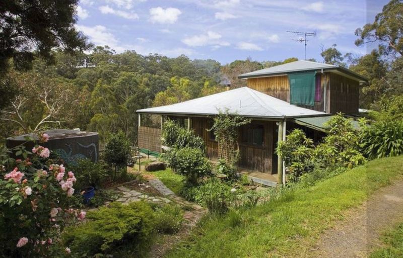

RE: The latest tale of woe
Here's a pic, the water tanks are on the left, one is out of shot. The 'agricultural' sunshading is gone, as are the crazy purple curtains. Above the driveway is a garage and the sheds with solar panels on them and the water header tanks.
Here's the view from the front deck, we just sit there reading and listening to the birds and frogs. Note the mowing on the paddock, we are in a fire danger area.
Cheers
Greg Locock
