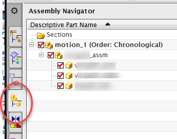

Have a look at the Assembly navigator, does it look similar to this ?:
Make sure that you "have left the postprocessor" ( press the "return to model" button)
File - Modeling
then Right click your assembly ( see "_assy" in the picture) and make it your displayed part.
Motion Simulation creates an "assembly" above your assembly where all the motion simulation things are saved.
NX should automaticly return to the motion_1 when you again select Motion appl.

Tomas thank you so much!
I did everything what you described but always missed the step to set my assembly as displayed part.
(In my opinion not very intuitive...)
Now everything works as intended.
