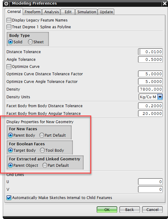

Hello
I have a problem with colors
When i do a subtract, few faces that are in contact with the subtrated body change color and become translucent
Other problem is when i create faces or radius, sometimes is with one color, sometimes is with another color.
How can i solve this?
Rúben Silva
RE: subtract change color of faces
Check the Preferences - Modeling - General :
( this is the default settings.)
Regards,
Tomas
Boolean faces as on "Toll Body"
