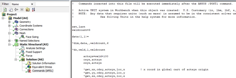

I need some help figuring out how to implement the macro using ANSYS WB.
I try to just copy it and paste it into Workbench as a command, but I must be missing something because it doesnt work for me.
Any additional details would be appreciated.

If you cut and paste the macro verbatum into a command snippet, you probably are not passing the number of welds to the script. Change the line "weldcount=arg1" to "weldcount=3" and it should work. Also, make sure you are in POST1 and do a set first. Also, the reaction file will be in weld demo_files,dp0,sys,mech.

Hi Rick, Thanks very much for taking the time to check this out. I certainly appreciate it. I will implement your suggestions and let you know how I made out. Thanks again and have a great day!
