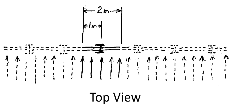

I am doing a preliminary design of a king post wall. I have determined the overturning moment as normal for a 1m width section (into the page). The posts are spaced at 2m c/c. My question is, how do you account for post spacing?
For a 2m spacing, should I multiply the overturning moment by 2?
I’m thinking should I therefore multiply the restoring moment by 2? I don’t think this is correct? Soil arching has something got to do with it. For example if the wall is at 3m c/c each post is taking 3 times the 1m width moment due to the lagging in between. However the passive resistance is based on the arching effect of the embedded portion ?

Yes, multiply the overturning moment by 2.
The "secret" is to understanding what is happening is:
1. Assume the wall is infinitely long.
Then, for randomly placed backfill, any local effects like soil arching average out. Each post will have (more or less) the same force to resist.
2. Carefully select exactly what 2 meters (width) represents.
If the 2 meters (width) is centered on a single post, a sketch makes it clear that each post (on average) must support 2 meters (width) of backfill. This 2 meter assumed length (1 post + 1 meter of wall on each side of the post) repeats along the entire wall. This makes the the 2 meter width of wall the "tributary area" for loading of one post.
Corners or wall terminations are different... but at those locations, the wall details may be also.
