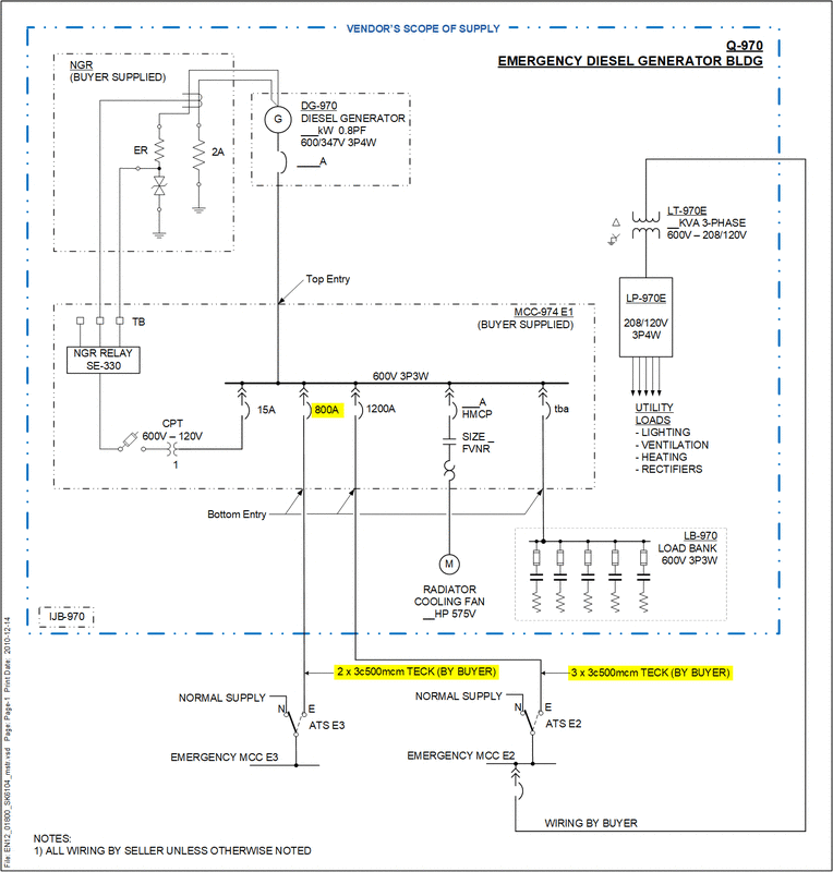

Howdy David,
It rally comes down to what type of (engine water jacket) cooling you intend employ.
The two major methods include;
1) Integral Radiator (ie engine driven)
2) Remote radiator
Your question involves the latter (Remote Radiator). The following 1-line clearly depicts how we facilitate powering the (remote radiator fan) motor. I this example the fan-motor was rated 75hp (on a 1500kW diesel generator).
FYI, The above 1-line is normally supplied as part of the tender docs when buying a standby-power gen-set.

RE: Diesel generator ancillary systems power source
Hi groovy.
75 HP seems a little harsh for a set that size.
Did you mean 7 1/2 HP?
Howdy Bill,
No, the motor was rated 75hp, 1200rpm. Other Bidders has similar sized motors (although one or two were a tad smaller).
GG
"I have not failed. I've just found 10,000 ways that won't work." Thomas Alva Edison (1847-1931)
Thanks for the clarification, GG. Was there a lot of duct-work involved? I used to be responsible for some 350 kW and 600 kW sets with remote radiators. The fan motors were very much smaller. (By more than the 600kW/1500kW ratio).
Hi Bill,
With a remote radiator there is no ductwork at all. That is the main reason for a remote rad. ie the rad sits outside usually on a platform. Obviously the heat radiated from the engine needs to be removed from the room, but that is usually handled by a few small fans. On a recent project these small fans (ie four x 5hp) were provided to remove heat radiated from a CAT G3612 900prm engine-generator set rated 2.6MW. All of these fans were inlet-blower type, rated 30,000cfm each. Exhaust air was via a ridge-vent (in the roof) as well as exhaust louvers (high on the walls). Each fan was ASD controlled with an integral TIC within the ASD. I think the scheme worked rather well, as I didn't hear of any complaints from OPS.
GG
ps As far as the motor size for the engine radiator fan, it appears to be the wild-west out there. There seems to be little consistency from one job to the next wrt fan motor size. If I recall correctly the rad fan motors for the 2.6MW project included two (2) x 30hp. On another project the rad fan motors were rated three (3) x 10hp for a 2.3MW gen-set. All of theses rads were sized and supplied by the engine OEM and/or the bldg packager.
