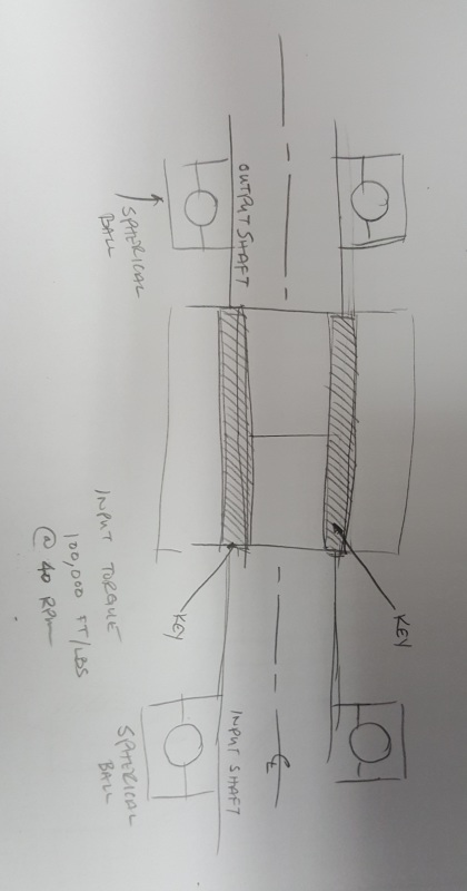

Good afternoon,
I am working on a rigid coupling that connects a gearbox to a driven shaft.
The shaft being coupled is a 10.125" Dia shaft (4140 @ 200-240 Brinell )seeing a 100,000 ft lbs of torque.
The shaft is keyed using a pair of 3.5 x 2.5" rectangular keys made from key steel @ 180 degrees apart.
The Rigid coupling halves (Ductile Iron) house a key each, and are approximately 22" in Diameter, and use (8) 2" Grade 8 bolts.
If I am understanding the power transfer correctly the two keys are carrying the torque transmitted by the shaft, while the rigid coupling bolts and the clamping force is just resisting the resultant separating force created by the keys.
Under that assumption the coupling is significantly over designed, but i am having trouble going through the calculations.
Any assistance would be greatly appreciated.

Yes. A drawing or a picture would be very helpful. I am picturing an axial split clam-shell coupling like the ones commonly used on older vertical in-line pumps, only much, much larger. If that is the case, I would think that the keys are not designed to carry all of the normal torque, but the interference fit between the bore of the coupling and the shafts takes the normal torque.

This is an existing design that I am looking to understand and optimize for casting.
There are many of these couplings utilized by existing equipment at my company without any recorded failures after many years of use.
JJP your impression of the coupling is spot on, and I was under the same impression that the keys were not carrying all the torsional load. But this began to come into question when I started asking about bolt torque, and achieved torque and prestress during installation of the coupling.

Maybe the torque is reacted by both the friction from the clamped-on coupling and the keys. You'd then have a sharing of the load and you'd have to look at relative stiffness. My bet would be that the friction load path is stiffer.
RE: Rigid Split Coupling Design with Two Keys
We had similar couplings on some large Alky contactors. The attached partial drawing shows our example. If I wanted to evaluate the suitability of this coupling for the torque it is driving, I would approach the problem as follows:
Determine the clamping force for each bolt based on the target bolt stress level. (I would use 50% of yield)
Sum up the total clamping force for all of the coupling bolts.
Distribute that clamping force over the area of contact between the coupling and one of the shafts.
Determine the static friction based on the clamping force and the surface characteristics of the coupling bore and shaft surface.
Determine the sliding force based on the maximum torque acting over that same area at the radius of the contact surface.
Compare the sliding force of the torque and the static friction from the clamping force to determine the service factor based entirely on the contact area without consideration of the keys.
I think the coupling should be designed to drive the full torque with a service factor of at least 1.0 based on the clamping force over the contact area and the keys should be a back-up to that.

JJP thanks for the response, I was thinking to follow this line of thinking. I plan on using this method, and ensuring the interference fit is sufficient.
Dan T,
The current design has a 0.002" interference fit so the clamping load can be transferred. So it does mimic the design you referenced.

This looks very interesting. In order to calculate the torque handling ability of the hub I would follow JJPellin's recommendation, however at that size of a shaft a 0.002" interference will be more than adequate to drive that torque. I can tell you from coupling hub design that an interference hub is limited by the stress riser over the key way generated by hoop stress from an interference fit. When in a clearance fit application a hub can be sized much smaller however if vibratory torque is present other problems will occur. So it is a balancing act. I think what you will find is you will easily be able to generate the clamping force and fit required to hold the torque, however in order to use a casting (reduced material strength) you may run into a scenario where you are stress cracking it by merely clamping the hub onto the shaft.
It may be a better design to actually clamp over the keys, this will eliminate the stress riser in the hub key way (and make it less expensive), but could potentially put more stress into the bolts. Then use a special taller key stock with clearance holes to take up the space.

I am not sure how you can state that the coupling has an interference fit of 0.002". The couplings of this type I am familiar with are bored and fully machined, and then saw cut into two halves. This leaves a generous gap between the two halves and the clamping force is driven by the bolting. Do you mean that the bore was cut for a 0.002" interference before the coupling was split? Or, was your coupling split with a milled joint and then final bored for 0.002" interference, resulting in no gap once fully torqued?

Looking at your sketch, something occurred to me.
How far are your shafts cantilevered from your bearings? If both shafts have a significant cantilever, you have room for them to strain, without the corresponding high stresses. Is that how rigid couplings work?
