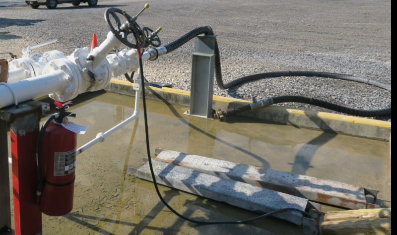

Thanks KoachCSR,
Just wanted to be sure. Yes, the pump nozzle will be changed and I attached a picture of the existing hose. As far as I know we will be reusing it and adding a second.
