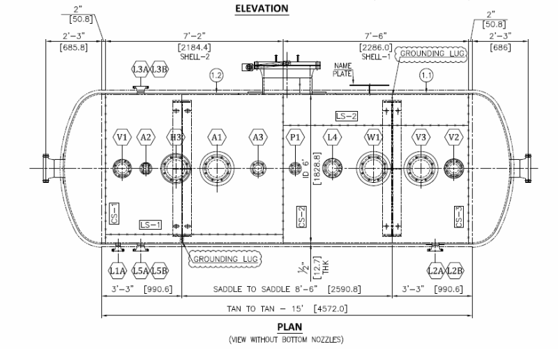

How to calculate the centre of gravity for a vessel?.....Please help
RE: Centre of gravity
Break your vessel into its components, work out its weight and that shapes C of G, add any particular weights attached, such as valves then sum them all up. based on some sort of grid system.
Or ask the CAD/3D system.
This assumes the vessel is empty, if not add weight of contents.
If you provide a bit more info such as a drawing or picture of your vessel it would help.

For eg- what would be the Ro and Rf for a vessel with dia 6'(1828.8mm) and thk 0.5"(12.7mm)
Attached is a vessel drawing pls help in determining Ro and Rf values.
Also help with determining its Cg ignore weight of the nozzles or any attachments just consider shell and D'Ends
Thankyou...
No idea what that equation is trying to calculate or its units, but looking at your drawing, if you're just looking at the vessel without considering the nozzles or the manway or the saddle and supports, the CoG would appear to be in the geometric centre of the vessel, i.e. 7' 6 from the tan line and in the centre of the vessel when looking end on. Or maybe I'm not understanding your question.
Why the bloody Hades would I ignore the nozzles and manhole in calculating the center of gravity of the vessel? By the way, you forgot the two saddles in your CG "ignorance" request as well.
