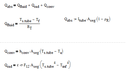

Could anyone please help me regarding calculating the surface temperature of HX tube and tubes are covered by aluminium sheet? In this case, the 5.02m^2 area is exposed to sun, 500kW/m^2 peak flux on surface, total no of tubes 20 are arranged in parallel manner in one row (parallel flow) and covered with aluminum sheet and the spacing between tubes is 2mm.
I have already calculated total thermal resistance, heat transfer to fluid , heat absorbed by tube, heat losses include reflection and convection. But the outlet temperature is not according to desired output.So what approach should i follow to solve this problem? The attachment includes the equations which i'm using to calculate the surface temperature. Thanks

My question is regarding surface temperature, i already have posted the equations. And mostly calculations are about the basic thermodynamic analysis. The crux of this problem is that the solar radiations hit on surface and i need to know best approach to calculate the surface temperature? What sort of the calculations do you need to solve this problem? Thanks
RE: Surface temperature Calculations (HX)
I am uncertain about the energy balance equation because that's according to the geometry of surface. I think i might have not included some aspect of surface or something is missing while taking account all factor in above mentioned equations.That's why the outlet temp isn't correct. Eventually those equations could be used to get the average surface temperature Ts? Thanks

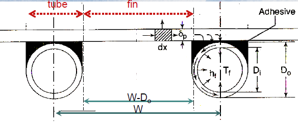

I have attached some rough diagrams of the arrangement of the tube & other stuff. I think you can get some good idea from this scenario. Thanks

Energy balance eq in case of heat conduction through Fin;
In fin case, the total area is considered carefully as area of conduction isn't simple.
Energy balance eq in case of heat transfer through tube;
The total thermal resistance is combination of conduction and convection.
By solving above those eq simultaneously, Ts for tube and fin can be determined. After it, average surface temperature is considered as overall surface temperature.Thanks
