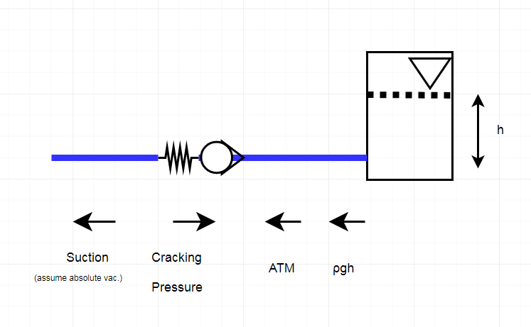

Based on my new understanding, my original diagram can be simplified substantially, as such:
Performing a rough energy balance on this scenario, assuming an absolute vacuum were possible, the maximum necessary rating for a check valve would follow the following relationship.
Cracking occurs when the pressures working against the check valve over come the forces working with the check valve...
Pressure_"left side" + Pressure_cracking = Pressure_"right side"
Pressure_cracking = Pressure_atmosphere + Pressure_ρgh - Pressure_"left side"
Using some real world numbers,
Pressure_"left side" = 0 psi ("Pressure_suction per the diagram")
Pressure_atmosphere = 14.7 psi (@ sea level)
Pressure_ρgh = assume 3 feet of water = 1.3 psi
Therefore, the maximum necessary rating for the check valve would be 16 psi. (In reality, it's less.)
So challenging this understanding, we could say...
*If the tank were substantially taller, say as tall as a skyscraper, than the hydrostatic pressure due to the weight of the column of water would be forcing against the valve, and thus a greater check rating required.
*If atmospheric pressure were lower, say at a very high altitude, than the force of the weight of air would be lower and thus a lower rating required.
*It is abundantly obvious that perfect vacuum would never be achieved, especially if water were performing the work which would end up eventually boiling, so there would be some vapor pressure term in there eventually. Also, my terminology for "Pressure_suction" is obviously bad. Thus, the pressures on the left side will always be quite remarkably greater than 0 psi, and highly improbably less than 14.7 PSI. Thus, it could be said 16 PSI cracking would be VERY generous in reality.
I think I got it now! (or do I?)
