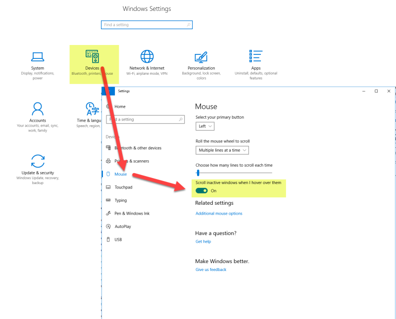

I recently switched companies, and I would love to keep my user interface more or less the same. I'm on 9.0.2.5 right now.
At my old company, when I brought up the Quick Pick menu, I could keep my mouse pointer in exactly the same location and use the scroll wheel to cycle through the features available for selection. Each mouse wheel 'click' descends the selected feature by 1 row.
Now, the scroll wheel will zoom in/out if I hold my mouse in the same place. If I want to scroll through the features in the quick pick menu, I have to move my mouse on top of the Quick Pick menu... and at that scrolls the whole window (rather than moving the selected line down).
Any advice? Thanks!

I don't think it's an NX issue, but something from either Windows or the mouse driver.
If you're on Windows 10, try turning off "Scroll inactive windows when I hover over them" (see pic where to find that).

Thank you! That was it.
