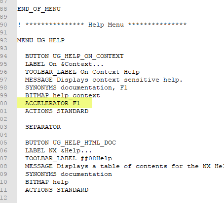

This is a hack to do what you want. If you update/patch, it will have to be redone.
Edit your ...\UGII\menus\ug_main.men file & search for UG_HELP_ON_CONTEXT
You will want to delete the line
ACCELERATOR F1
This is how the F1 key is assigned to help. You can then customise to change Hide to the F1 as you were doing.

Here is a method that will prevent the need to re-do your change when patches are applied and will make it much easier to migrate the change to different NX versions as well:
1. Create a folder where you want to store your menu customization.
2. Create a folder called startup in this location.
3. Create a text file and name it <something>.men. Mine is named edit_ug_main.men
4. Add the text below to your new .men file, replacing the text in <> with a shortcut key for the on context help. Ex: Ctrl+Alt+F1
5. Save and close the file
6. Edit you custom_dirs.dat file, adding the path to the folder you created in step 1
This will override the default menu so when you open NX, the hide command will be F1 and the context help will be your chosen shortcut. If/when you move to a new version of NX, simply edit/replace the custom_dirs.dat file and the commands will be remapped in that version as well.
Text for .men file:
EDIT UG_GATEWAY_MAIN_MENUBAR
MENU UG_HELP
BUTTON UG_HELP_ON_CONTEXT
ACCELERATOR <place new shortcut key here>
END OF MENU
MENU UG_EDIT_SHOWHIDE
BUTTON UG_EDIT_BLANK_SELECTED
ACCELERATOR F1
END OF MENU

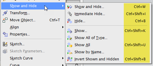

I do not like to tell people what they should do but i will make an exception here... smile
The shortcut for hide, has been Ctrl+B as long as i can remember. ( yes, a pretty long time.)
- Put useful shortcuts where they are missing , and use the existing as long as they are ok.
The old name for "Hide" was "Blank", which ... = "B".
As well as Ctrl+Shift+B for invert
and "...U" for the old name "Unblank" =Show.
Do not try replicate the shortcuts from another system, chances are you will spend many hours and in the end it's still a different system.
Now that you have replaced Ctrl+B with F1,
what will you do with the rest of these shortcuts ?
Learn to live with the existing ones, add missing ones and spend your time on creating revolutionary designs instead! smile

A few observations:
- The entire time I have used NX (several years), I have used function keys for my most common commands (hide, show, move object, layer settings, measure, etc). These are as hard-wired into my mind as Ctl-B is for you.
- Given that Hide is among the top couple most common commands that everyone uses, it seems strange to make it a two-key shortcut, and one where you have to stretch your hand. And "Show all" being a 3-key shortcut that spans the width of the keyboard, I can't reach with one hand. That means I have to remove my left hand from my spaceball and my right hand from my mouse, just to access a commonly used command. Does that never bother you?
- There is no "B" in hide, and no "K" in show.
- There are enough keys on the keyboard, plus 32 radial shortcuts, that I don't have to use any multi-key shortcuts if I don't want to.

RE: NX custom keyboard shortcuts
I am not upset, not the slightest.
You have fully valid and good points on the current , un-logic, and inefficient shortcuts!
When Unigraphics evolved into NX a development effort was to clean out poor user interface and rename old Unigraphics terms into the current more or less de-facto standard.
a few examples of that : Blank/ unblank Renamed into Hide/ show, Hollow-> Shell, ...-> Blend, Transform -> Move etc. But, the shortcuts stayed !
On the Transform/ Move, as most functionality was transferred from the transform function to the new Move, the shortcut Ctrl+T was moved over.
- Maybe there should have been an face-lift on the shortcuts as well.
- There are as you note a full keyboard waiting to be used, H for hide and S for Show ?
- But, S is assigned to "spline", H is unassigned.
