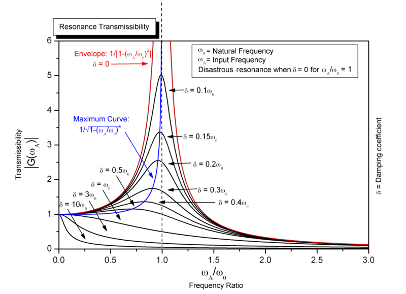

Adding steel strategically might add/increase stiffness. That could change the tuning of the floor system and make the vibration either better or worse if resonance is involved, depending how close the forcing frequency is to floor system resonance now.
Even if the new steel is added non-stategiclly so the principal effect is mass increase, mass isn't damping.
For constant speed equipment mounted on well designed real soft isolators, damping can actually increase transmissiblity according to most isolation curves.
http://personal.cityu.edu.hk/~bsapplec/Fire/Image4...
Successfully Isolating equipment when it is not on ground floor slabs can be quite tricky.
https://www.mason-ind.com/ashrae-lecture/
