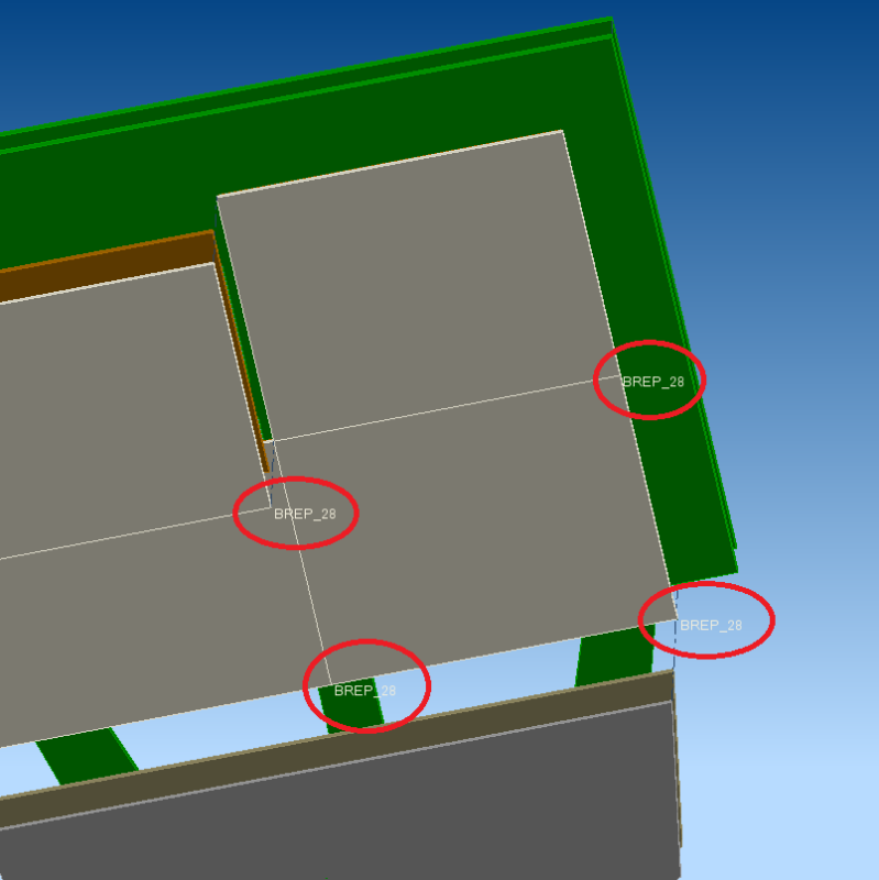

Below is an attachment of an assembly with parts with the name of "BREP_28" Where is NX picking this up from. It's not in assembly tree. I see it nowhere, even picking on the parts. Can I change this to a part number or material property or any other field in properties.

Those are names of objects in one or more of your files. I'd guess they are names of the body objects; you can check by selecting a body and going to menu -> edit -> properties -> general. If there is a name entered here, it will show up when you turn on the "show object names" option.

Brep is ( normally ) short for "Boundary Representation."
Brep is another term for solid body, a solid body can be of different types of definitions , but the Brep type is today the common.
( Brep/solid modeling is something one can doctorate at, the above is the level i know... smile
If i guess you have in that assembly also some imported data from Step or JT or ....
Those solids probably have the name "Brep_28" assigned.
- Look in the Part Navigator rather than the Assembly navigator.
