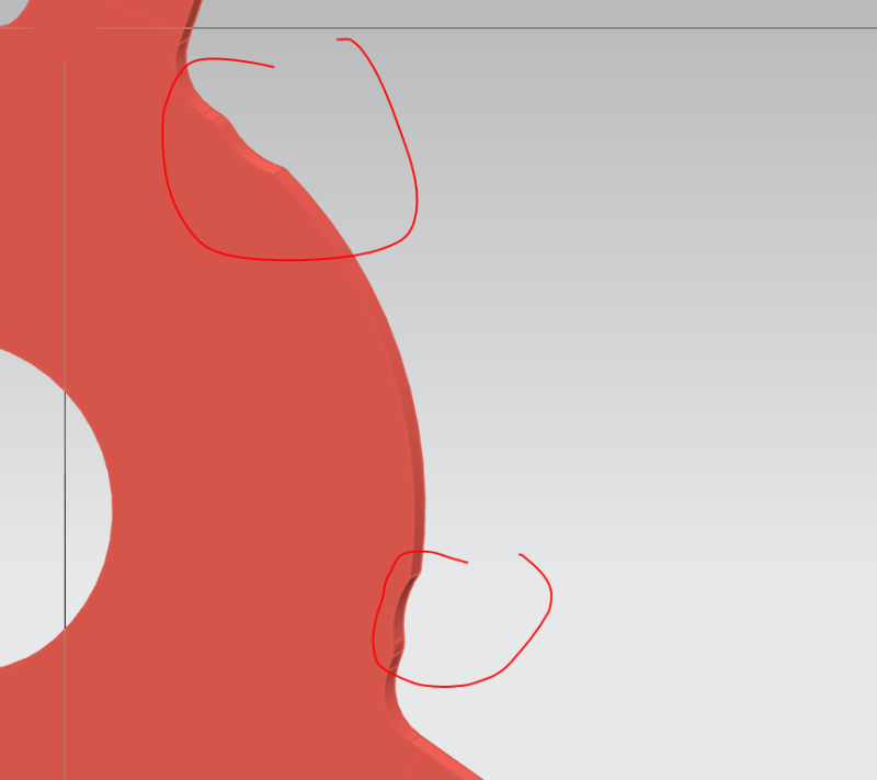

Hello to All,
I'm currently working on a progressive die design project.
And the customer has advised to add cookie bites and coining operation in the strip layout of given part (bracket).
So, can anyone please let me know what is cookie bite and coining and why/where it should be added?
Thanx in advance.
Vikas R.

RE: Sheet Metal stamping- coining and cookie bite
A cookie bite is a small half-round notch when 2 trim steels come together, so you don't get a sharp step.
Thanx Rob!!
that was really helpful.
can you please explain to me that how to put coining punch between cookie bites especially on the top of bracket's face where flatness plays the vital role.
you can share any sample model or picture to understand its features and appearance.
