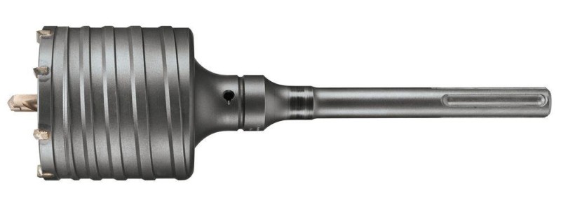

I often use a rotary hammer drill. Not much vibration. You could buy a cheap core bit just to get a clean cut at the surface and then drill the rest.
RE: Drilling a new drain hole in floor
...one of the strangest thing I ever saw was on a island in Micronesia about 2 decades ago. Concrete framed building with RC walls. GC cast the door opening too narrow so 8+" of concrete had to removed from one side of the 6'6" height. Accomplished via a PVC tube with a hardened nail through one end, and a hammer (made from #6 rebar 'handle' welded to a #8 rebar 'head'), and one very, very patient, diligent laborer who chipped away...and remarkably plumb and flush. He did what his boss told him to do.
Back to the OP's question: For such a small dia hole AND access to a percussion chipping tool, consider the use of a dry-core bit:
For a 5" thick slab (and assuming you don't hit rebar) such a hole would take less than 15 minutes - do it after hours to minimize noise/vibration.
Or wet core it - diamond wet-coring for a 2" hole has minimal (nil?) vibration and very quick with a correctly selected diamond matrix.
