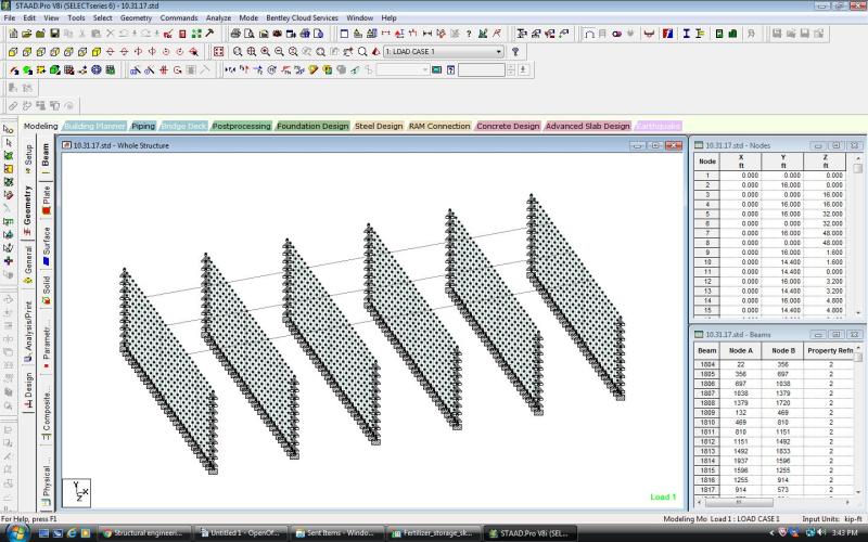

I guess my curiosity got the better of me.....so I made a crude model of this in STAAD....with about 3 braces per top of wall. (See below for a pic.)
One thing I tried was to load 3 of the interior walls on one side and in only one direction (with the other walls unloaded). And what happened was the braces in several bays went into compression as the wall shared the load based on flexural stiffness. I didn't bother modeling the side walls because the results will probably be the same. (Especially for the middle brace.)
So in conclusion: I'd just forget about a tension only brace.
