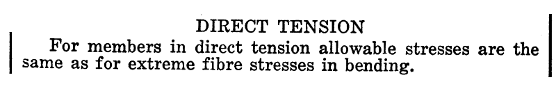

I am doing the analysis on roof bowstring trusses from 1943. The attached note I think means the wood was to have 900 psi bending strength and 1200 psi axial but I am not sure. It looks like there may be an "f" after the 1200 psi. The tensile strength of wood is commonly listed as much lower than the parallel to grain compressive strength in NDS. If the 1200 psi represents axial, was it common back then to use that for both tension and compression?

haynewp - From the 1942 Southern Pine Manual, allowable tension stress was considered equal to allowable bending stress:
Also, the nominal lumber sizes specified in 1943 were larger than today.

I came across that info too. Apparently, tension values were significantly revised in the 1960’s.

from aitc:
From at least as early as the 1930’s until the late 1960’s the tensile strength of lumber was believed to be equal to or
exceeding that of its bending strength. The following statement from the 1935 Wood Handbook reflects this belief, “The
tensile strength of wood is greater than the modulus of rupture as obtained from bending tests. Hence stresses in the
body of a tension member fully equal to those given for fiber stress in bending…are justified.” (Wood Handbook, 1935,
p. 105). Limited full scale testing in tension parallel to grain resulted in failure of the wood specimens due to crushing in
the test machine grips prior to tension failure.
This belief was held until the 1960’s when improved grips for tension testing were developed to determine the tensile
strength of machine graded lumber. With improved grips, the testing of full scale specimens indicated that the tensile
strength was significantly lower than previously assumed. By 1970 virtually all of the lumber grading agencies had
reduced their published design values for tension parallel to grain to reflect this new knowledge.

The attached from the manual that SRE found has both a 900 psi stress grade (No 2 medium grade) and a 1200 psi stress grade (No 1 grade) in bending listed. So now I am thinking maybe it was understood back then that the chords were made from the higher stress No 1 grade and the webs from the No 2 medium, instead of the 900 psi being the required compressive strength and the 1200 psi being the required bending strength. Or maybe each grade was common for members of a certain dimension and that was the understood intent. I am not sure what to use now.

It's almost exactly the same. I see the note for fc=880 psi and fb=1200 psi. Thanks!
RE: Old wood stress values
haynewp - You are welcome. Also, note that both top and bottom cords are built-up members. Although the "repetitive member factor" did not exist in 1943... those members are repetitive. I would give that information, together with larger dimension nominal size lumber, due consideration for the analysis.

I don't know for sure this is Southern Pine since the original drawings did not say, but based on my research into what was commonly being used at the time and that diagram and values from the 1942 Southern Pine Manual I feel a lot more confident that it is Southern Pine. It kind of looks like Pine too (attached). I am trying to figure out what the best comparison of today's NDS values would be to use for the analysis given the fc and fb listed on the original drawings and figuring this is So Pine. There's not an exact match for current fc and fb based on what the original drawing listed. I understand that wood used to be of better general quality than today, but the testing has also been advanced to give more accurate values (hence the whole tension value issue mentioned above).

haynewp - From the photo, I'm 99%+ sure that is southern yellow pine, and high quality, too.
As for the design value, take a look at the current southern pine, visually graded, design values. NDS values come directly from this data. IMHO, it is then time to apply engineering judgement to select a reasonable set to use for the calcs. Here is what, and why, I would select:
Assuming the 2" to 4" thick, 2" and wider range, Southern Pine, No.2, Dense - Not because that is what the lumber is, but because that designation has values are a good match for the most dependable 1943 values. The most dependable values, in my opinion, are Fb = 1200 psi and E = 1,600,000 psi. Then use the other modern values for that grade. There is so much variability in wood, that pinpointing an exact value for any design value is futile.
For example: In 1967 tests by the Forest Products Lab, measured failure of #1 SYP for tension parallel to grain varied from 1570 psi to 12,640 psi, with an average of 5480 psi.
For #2, the range was 1000 psi to 10,430 psi, average 3400 psi.
Making a well thought out and reasonable choice of design values is as good as it gets.

Thanks. I am going to assume the same No 2 Dense for the 4x8 bottom chord members (mine are 4X8's instead of 4X6's that are shown on the 1942 diagram).
