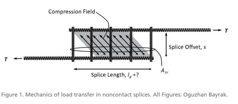

For a heavily loaded power station, A girder beam having a 500 mm set down is required to design(refer attachment). This girder is also supporting spandrel beam exactly at the set down location. The design procedure that I have followed for this non prismatic beam is as follows
1. The beam is modeled using frame element as a sub frame.
2. Two different frame elements are defined for the different two sections and they are combined using insertion points & thereafter loaded the beam
3. Analysis results are obtained and the bottom flexure r/f are derived using the 750 mm(D) dropped section & continue through out the bottom
4. Top r/f at restraint ends are also calculated for respective sections(1250 and 750 mm D)
5. Links are calculated from the analysis results at both ends for respective sections while provisions are made for the hanger links also
6. The Detailing is done as given in the attachment
Please comment if there are any more considerations on analyzing, designing and detailing to be done for these kind of beam sections

2) Given that you're pursuing end fixity of sorts, I question whether it's appropriate to utilize compression reinforcement for deflection control here. The most critical locations for that reinforcement would be the bottom steel at the ends and the top steel in the middle. Your bottom steel at the ends may be ineffective unless you can develop those bars into the columns in straight compression development. And your top steel at mid-span will be partially compromised by the fact that you're passing the compression across a 500mm step which means that your compression is back in the concrete for a spell there. All tolled, that would be too much uncertainty for me to feel comfortable relying on compression steel.
3) In any detailed deflection analysis, I would model the step as though it occured 1000mm to the left of where it will actually be located. It takes some distance for the compression force in the beam to shift across the vertical offset and, in my opinion, one needs to take account of that to avoid underestimating the contribution to flexural strain there.
4) At the step, you have not said anything about how far the top bars in the shallow section will be extended into the deep section. I'd want that to be at least compression lap length + 1.5 x 500.
5) At the step, you will pass the compression force in the top steel across the 500 mm step. That, effectively, is a non-contact lap splice which will create a local demand for link reinforcing that you haven't mentioned. See the sketch below but imagine the rebar in compression rather than tension.

1. Column dimensions are 500 mm Deep(in plane)x750 mm wide (out of plane). F2F height nearly 3.8 m. This sizing would induce some fixity.
2. I won't utilize compression reinforcement for deflection control. I haven't made such a statement. The beam is just singly reinforced section. Strength is controlled by only tensile yielding. The mid span top bars are just link hangers. But the top bars at column are to cater flexure induced by the fixity. It's just simple. When there is column fixity present at support location, deflection is reduced in compared with a pinned connection. Simple sub frame with columns
3. Helpful
4. Just hangers at the mid span. Nominal anchorage would be provided in to the deep section
5. Helpful. But this will only required if the top bars are in compression. Is n't it???
Apart from that I have seen some designers uses very close spacing of links in the vicinity of the step(To both left and right). Is it required??? What would be the reason behind it??

You'll have a different version of the same problem if the top bars are not used in compression. The compression force in the top of your beam on the deeper side will need to be "turned" diagonally as it dives down to meet the compression force in the top of the shallower beam segment. That "turning" at the knuckle will produce a tendency to pop out the concrete at the change in direction of the strut. This can create a demand for links locally at the high end of the diagonal strut. I don't know that there's a matching demand at the low side of the diagonal strut so long as shear has been properly designed for there.

The diagonal thickness through the throat of the step needs to be the same as a the beam depth. This will give you full capacity using the same reinforcement.
