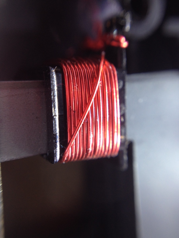

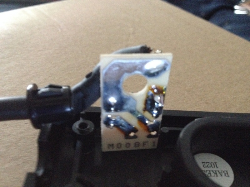

Here are a few photos of the internals.

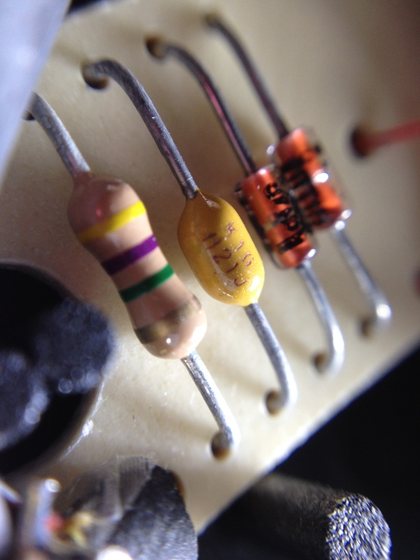

Unfortunately these are the best photos I could manage to take, and even with my microscope I still can't read what is printed on the diodes.
Is it possibly 914, on a least one of them?
There are 16 turns of 0.014" wire on the ferrite, and the ferrite measures 1 inch square, and the cross section is 0.25" x 0.25"
The screen of the main coax cable is soldered to the main solder mass that you see on the board underside, and the core of the coax is soldered to the pad nearest the resistor, like you can see on the first image.

RE: Sparkplug Clamp Pickup Sensor Circuit Fluke RPM80
4.7 Mohms looks awfully much in an application like this.
The secret for successful operation is probably in what ferrite you use. I would guess a hi-permeability medium frequency quality.
Perhaps "1N3" is hidden under the diode and it's actually "514A" on the next line. 1N3514A sounds plausible... That would make it a 6.8V zener.

I just had another look with another microscope.
They're both 914B
I recreated the circuit (using 2 off 1N4148 diodes instead), and built it into an old timing light clamp on pickup.
The output is identical to the Fluke.
