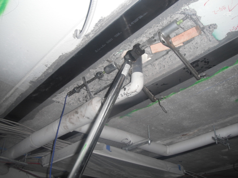

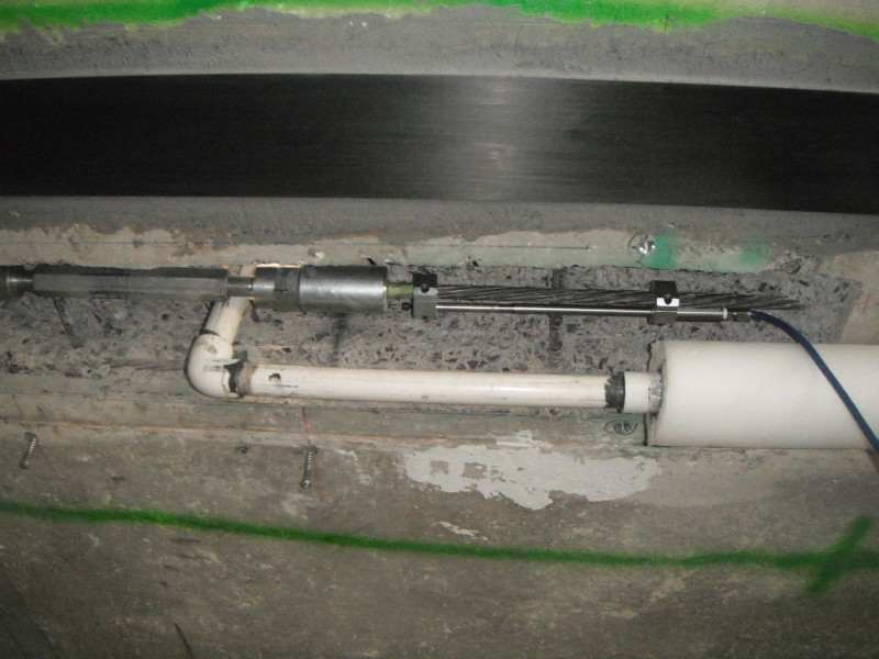

I have purchased and used GEOKON [Link] digital instrumentation. I recently had to measure strain in a bare prestressing strand over a short 8" gauge length, so I purchased a vibrating-wire digital strandmeter (a displacement transducer) [Link] from Geokon with a 4-channel data logger. It was less than $2k, including the PC-based software. With the data logger [Link] and software [Link] you can vary the reading frequency (several times per second, several per day etc).
Geokon also have a wireless option to a datalogger that I believe enables you to remotely monitor the data.
The software is very simple to setup, and the datalogger did not require a EE degree. It took me about 1 hour to setup and start collecting data.
Geokon have excellent customer service and outstanding products. My contact persons at Geokon is Brian Brown. It is worth a call to one of their tech specialists to see what is applicable and affordable for your situation.

dik:
This is pretty cool technology - easy to use and inexpensive and therefore not just for university research and materials testing labs.
It was by necessity that we purchased the equipment for a project. A GC cored through pretensioning strands to several precast planks and when you use GRABB-IT strand-splice devices [Link] the manufacturer has a recommended torque be applied via a calibrated torque wrench, with a chart that correlates torque to pretension. We were not satisfied with such a manner of determining the magnitude of stressing force so we opted for the vibrating-wire 'strandmeter' that was installed before/during/after the torque was applied. We also used the 'strandmeter' to then monitor the 'strain' relaxation over 24 hours to see if there was any end-slip. The datalogger is able to store data without being hooked up to a PC so we enclosed the datalogger in a Pelican case and secured it with a padlock to keep construction personnel away from the electronics - then after 24 hours hooked up the PC to the logger and grabbed the data. The logger also records strain and temp for each time record.
I just checked the purchase invoice. Total price for VW strandmeter, 4-channel datalogger, USB and all cable connections and software was US$1,800. Early 2016 purchase.

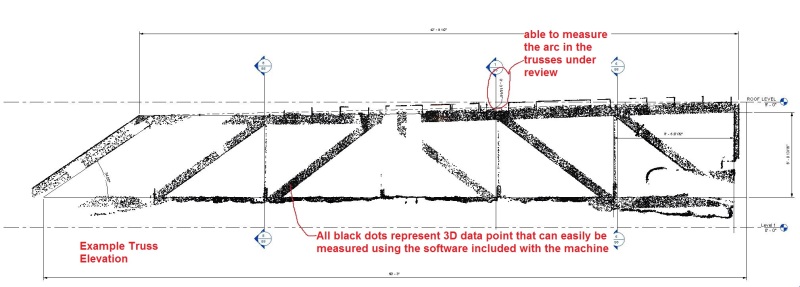

We are monitoring the heave of a floor slab using a 3D laser scanner. We have also created as-builts of a 100'-0"+ tall grain elevator that was being re-sided. This technology is becoming more common. How well this would work will depend on your access, visibility of the structure, and the amount of mech/elec items affixed to the wall. The one downside of this technology is the quantity of data collected. We are routinely working with 20million + points of data. It collects the data fast, but the post processing can take a bit of time.

I have included a couple samples from a recent scan of a building we repaired. This is not a long term monitoring assignment, but it seems the most germane to your project. If you have an open ceiling, this is much easier. In this case we were dealing with trusses built in the 40's. Over the years they have crept, and one particular web member was bent beyond belief. The owner in this case was not well funded. The goal of the scan was to confirm if the trusses were plumb, see if other members were bent, and try to determine the cause the movement. In approximately 40min we completed two scans and collected 10 - 20million data points. These were easily imported into Recap and ultimately into CAD software for review. If this were a case where we needed to monitor the building we could do that easily as well, but we would need a surveyor to setup control points.
Pictures would be helpful. Considering the age of the structure, and the type of construction it seems to be a significant asset that the owner wants to save dearly. In that case, the cost does not seem quite as paramount as if this were a structure of low value. Surveyors own this technology, and you can even rent scanners if you choose. You can go onto the 3D laser scanner forum and find any number of companies that do this type of work. We are in a remote location, so we invested in the technology for our own use.
