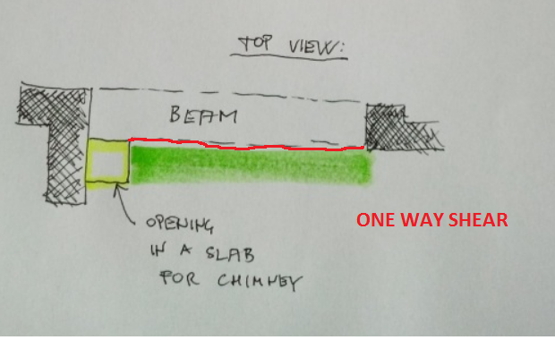

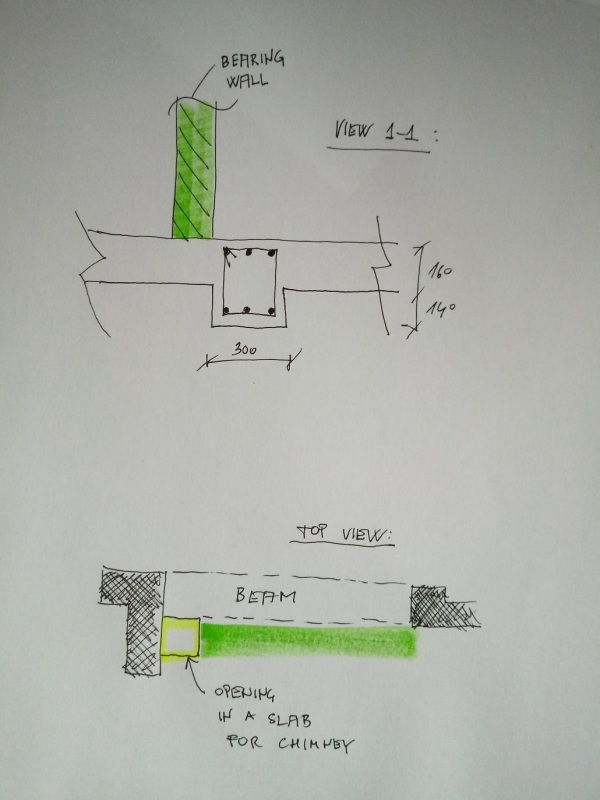

I have a RC beam that is integrated in RC slab.
There is a bearing wall on a slab, but not on top of a beam but right next to it.
There is also a hole/opening in a slab for chimney right next to a beam (in a same line as bearing wall).
Im wondering is this something to worry about - how bad is this? What can be done? I cant change geometry/position of chimney or beam. Will a load from a bearing wall be transfered through a beam since its right next to it? Slab is 160 mm thick. Load from a wall is around 40 kN/m (slab shear is not a problem). I wouldnt be concerned if there was no opening but now Im not so sure.

Thanks for replies!
English is not my 1st language so correct me if Im wrong - by ONE WAY shear you mean a shear that goes along the line of the beam - red line in picture below.
I made a slab shear control for cross section b/h = 100/16 cm and it got me around 60 kN/m of shear capacity
load form wall is 40 kn/m so it should be alright. But what kinda bothers me is this - doest a bearing wall above a slab transfer loads (self weight + slab above) with compression arch which means that loads (shear forces) at both ends of the wall will actually be greater (concentration of loads). because load of 40 kN/m is pretty idealized - distributed uniformly along the whole lenght of the wall.

I'm not sure I follow what you are saying.....but I think the wall being adjacent to the beam means a lot of the shear will probably run directly into the beam. You can probably run a FEA to be sure.

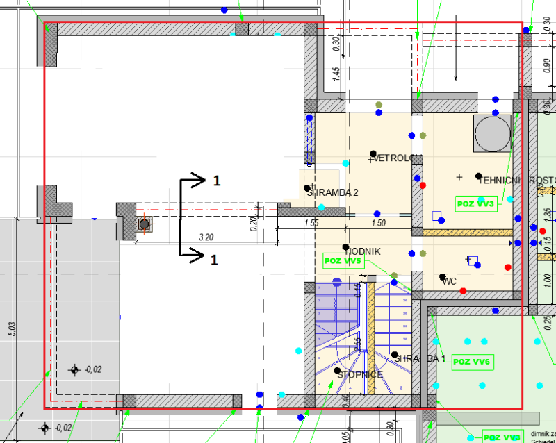

I'm not 100% sure myself because looking at your bearing wall layout (if I am reading it correctly).....that could mean some 2-way action. But even with that, you could hit some peak shears (at some locations) near to the one-way distribution value.

That was my point with the two-way shear. The wall will only arch if there's hard spots in the suppport. You've got one of those, to an extent, at the right end. Hence the extra margin of safety. You're unlikely to ever know the exact load distribution with any certainty.
