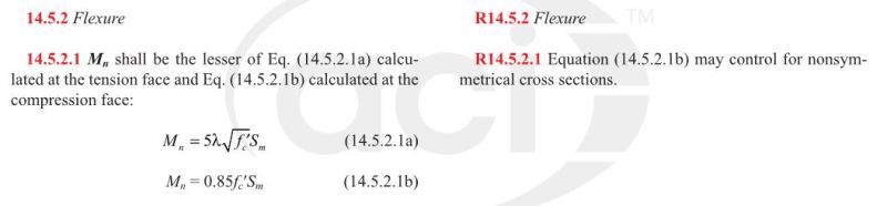

I'm having some trouble understanding the meaning behind clause 22.6.5 in CSA A23.3-04. It states that for plain footing strength in bending "The factored resistance in bending shall be based on a maximum stress in tension of 0.37*lambda*phi_c*sqrt(f'c) and a maximum stress in compression of 0.75*phi_c*f'c". If I was to do a bending calculation and limit the tensile stress to the value given in the code clause, would the compression side of the footing not just be stressed to the equal and opposite amount, with the neutral axis occurring in the center of the footing? When would the compression stress limit ever apply? I feel like this is a basic question that should be easy to figure out with basic concrete principles, but for some reason it's not making sense to me.
RE: CSA A23.3 Plain Footing Bending Resistance
In plain flexure, the tensile stress would always govern. If the footing as in significant compression (granted such a condition is a long shot) then the compression stress might become governing. I imagine CSA simply included this for completeness. This compression limit is, after all, lower than the compression limit given for reinforced flexural members.
@atrizzy That makes sense, for whatever reason I thought the code was trying to imply that you could develop the full compression stress and tensile stress simultaneously. I'll continue on with limiting my compression stress to an equal and opposite value from the maximum tension stress.
Shotzie, think of it this way. They wouldn't instruct you to limit the tension AND compression stress to the lower value, since the compression stress obviously need not be limited to that value. The fact that the tension component tends to govern is incidental.

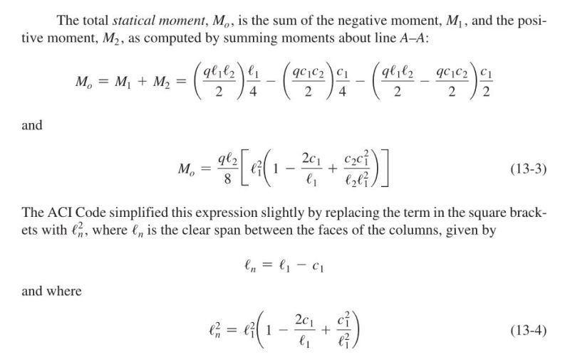

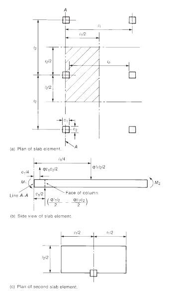

Why would such a procedure be unjustified? As I understand it, taking moment at the face is based on the derivation below. It's MacGregor rather than Gamble -- my bad. It seems to me that the same logic could be applied to both columns in a combined footing regardless of the relative loads.

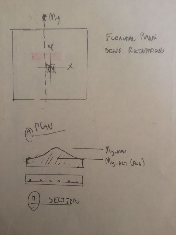

I agree that moment peak smoothing can be applied in both directions simultaneously without double dipping. What I do believe is double dipping, however, is to both take moments at the column faces AND reduce moments by explicit consideration of compression / distributed load. That, because they would seem to be mathematically the same phenomenon.
Thus far, I've been misunderstood in my concern. My concern is not about moment peak smoothing but that, in any direction, when we evaluate flexural capacity against what is, implicitly, and average moment demand that does not capture peak stress. That strikes me as a problem when the mode of failure is brittle, tensile concrete failure based on the flexural modulus of rupture. I feel as though we're assuming a redistribution capacity that doesn't exist. I've obviously done a terrible job of expressing my concern so far so I've included a sketch below to try to help with that. If others are doing this kind of thing more rigorously, I'd love to hear about it and how it's being undertaken. As I see it, we're designing to uniform, lateral moment distribution that is fictional.

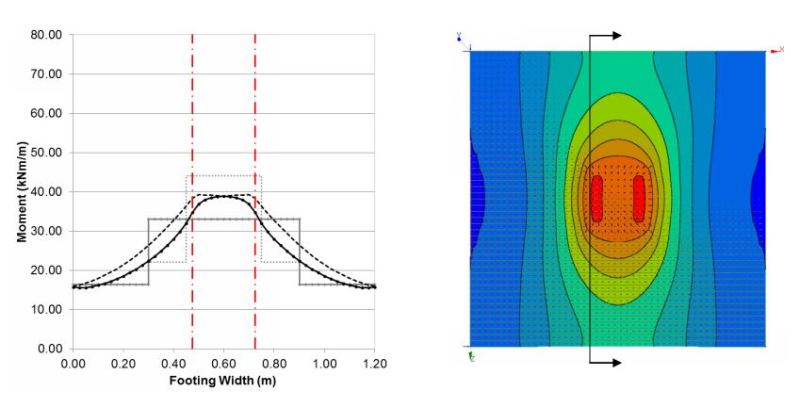

On the double dipping, starting on page 37 has a good presentation. We may be assuming a lateral distribution that doesn’t exist but it is permitted by my Code and has always worked as far as I know. The column and middle strip method would be better to account for that lack of lateral distribution ability when doing hand calcs.
https://repository.up.ac.za/bitstream/handle/2263/...

Quote (haynewp)
It's a fine presentation of FEM results (below) but the document is entirely geared towards reinforced footings which will tolerate inaccuracies in the assumed lateral distribution of moment. My concern is for plain footings where, one would assume, first rupture = failure. To my knowledge, we in north america don't even have the SD methods represented by the step functions in the graphs below except to the extent that designers might wisely be doing that of their own volition. Folks just use the straight average moment.

@shotzie: this commentary section from ACI may give a clue as to what scenario the code writers had in mind when they decided to present different tension and compression values. Of course, you don't see many footings that would have geometries producing different S_top and S_bot values.

You get full marks Hokie but I still think that there's value in quoting an "official" source for confirmation. I wouldn't have stumbled across it had haynewp not had me looking into the safety factors for plain concrete.
