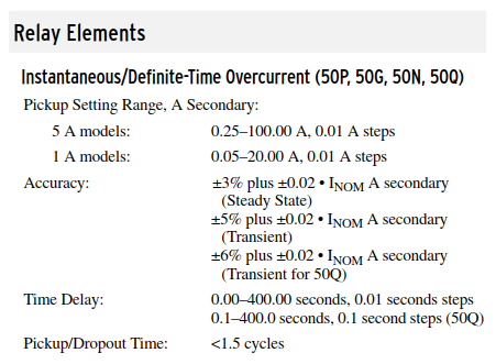

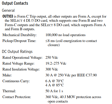

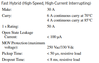

Here are some screenshots from the SEL 751 manual.
Instantaneous 50 settings:
Intentional time delay: 0 to 400 seconds
50 element Pickup time: < 1.5 cycles
Standard contact closure time: <= 8ms
Optional Hybrid high speed contact closure time: < 50us
So you would need to add these times together along with your breaker operating time to figure out the overall clearing time.
