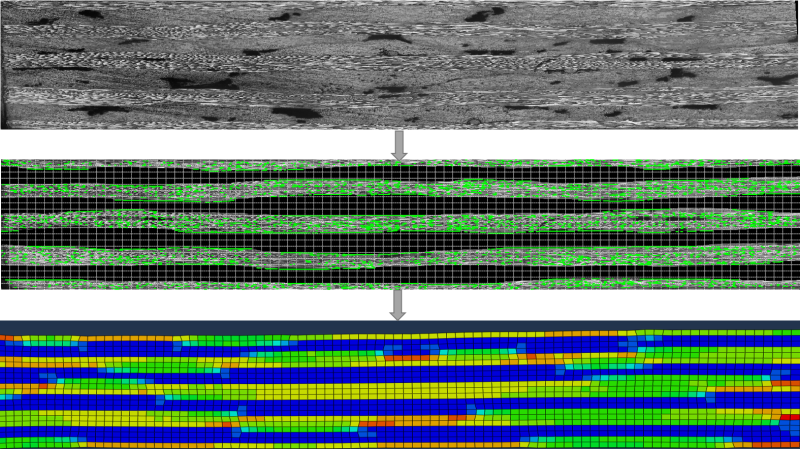

Its been quite a few years and I’m more of a powerpoint monkey these days too, but I’ve done something broadly similar with building models of composites from microscopy images (see photo). We have a program that would overlay a mesh on an image, identify the fibre orientation in each element of the mesh and then create a file that listed every node (plus it location) and the fibre orientation associated with each element. I wrote another program that would take this file and build an input deck for ABAQUS from it. To do this, my program would give every element its own node set, element set and material property card in the input deck. As every element has its own material property card, you can change the properties of each element. I did this so that I could have different fibre orientations and damage criteria for each element so this sort of approach should work for you too.
RE: Assigning material properties to each element
I’m guessing that you don’t have the ability to get fibre orientation data for the bone but I do have a cool idea (well, I think its cool) of how you could assign orientations/anisotropic properties to each element. Once you have your model built with every element having its own nset, elset, material, etc… you could then apply a ‘real world’ like load. You could then find the direction of the max principle stress for each element and then use this to assign an orientation and/or anisotropic properties to each element; virtual Wolff net bone remodelling!
