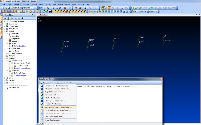

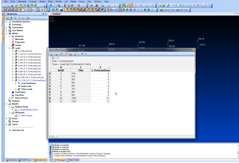

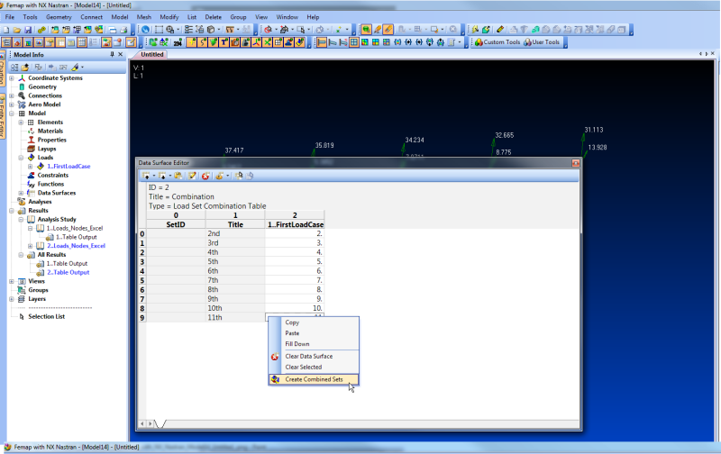

With the method described in the video, that would require you to repeat the process 16 times, if you wanted to create new load sets. 16 is better than 96, but if you are creating loads that can be incremented, such that load set#2 = 2* loadset#1.. etc... you could use the Data Surface Editor (Tools \ Data Surface Editor, or Toolbar Icon)
