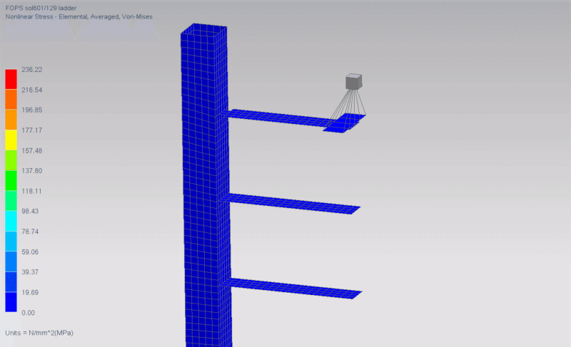

your task reminded me our older example what we use for training purpose:
heavy object is dropped on the transom of ladder. Weight of the object and height is known, so the velocity is known as well.
The object causes large displacement of the first transom, there is assumption that this first transom will not withstand the impact and after its fracture the object will continue to the secound transom - but with smaller velocity (and energy).
Here is the animation what I mean (model and loading is symmetrical, there is therefor only a half)
(1) How do I do the velocity to enforced displacement conversion?
Yes you can of course do it, convert to displacement or acceleration, you can do it "manually" in f.e. Excel in the form of some tab with some very small increment and then import it to NX.
Or there is a special tool in NX, you can covert it automatically.
But why? It seems to me useless.
Firstly think about strategy, which solver you would like to use?
In my example, we need to consider: large displacements and strains, frictional contacts, nonlinear material model, and possibility to change time step in case of divergence.
Modeling of fracture is just a "bonus", model is definitely reliable for simulation of fracture, keep it as example.
It was therefor chosen implicit transient SOL 601-129. Alternatively explicit SOL 701, typical for wave propagation problems.
Here you can define velocity directly, you don't need any conversion.
Is this what you want?
Main advice: keep it simple as possible, reduce complexity, number of DOFs...this is not fun to manage it compared to traditional static structural analyses.
Good luck and regards,
Jan
