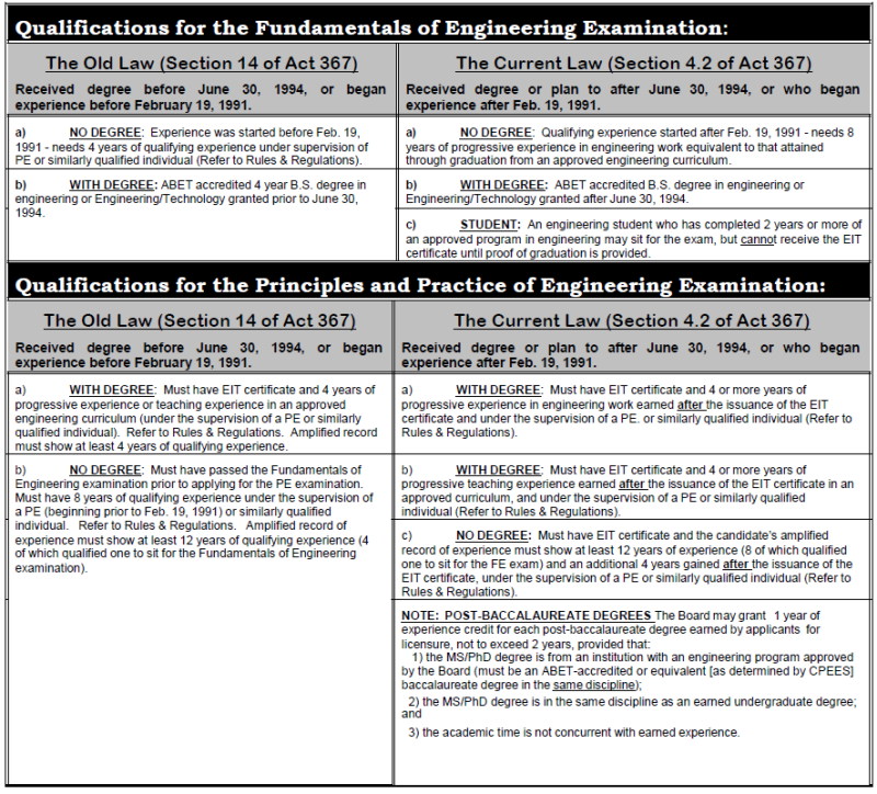

Hi everyone. I’ve followed this forum for many years and I think it's one the best in the engineering field. I don’t know if this is the right part of the forum to post this. Well, let me tell my story.
I am a BSc (a 5 years degree) Mechanical Enginer from Spain with a 5 year experience in a manufacturing company ( metalworking sector). We have clients in France, Germany, as well as in Spain, of course. Well, I’m moving to the US in the next months because of my fiancée (US citizen). I already have an approved visa to go there so I’ll have the work permit in some months and I’ll be able to apply for my green card right after getting married. So I’ll be there with work permit, residence and so on….. I’ll be living in PA (close to Philly). So I don't need sponsors......
Basically, I would like to know whether employment opportunities are approximately equal for foreign and native engineers when it comes to an employer, or employers don't even look at foreign applications and I need to obtain a MSc in order to successfully enter the market? I contacted some recruiters there and they told me different answers: it doesn’t matter where you come from and yes, they normally prefer US engineers.
Is it also necessary to take the PE exam? I know it is only required for certains jobs but it may improve my employability. I’m slightly “lost” regarding engineering licensure in the US.
Thank you in advance for your opinions and advices.

My opinion, based on my previous work experience:
You have resolved most of the roadblocks to getting hired as a Foreign National in the US: green card, visa, work permit, no sponsorship required, English language. The previous companies for whom I worked would certainly consider you.
A PE license is not needed unless you will be doing the kind of work that affects the Public (bridge design, building design, HVAC design, etc.). Metalworking (machining?) is Manufacturing technology and a PE is not required. It may help as a recognized measure of competence, but is not required. I've had my PE for 30 years and never had the need to stamp a drawing because I've worked in Manufacturing. But it helped set me apart from the masses.
The challenge you will face will be convincing potential employers that your degree program content is equivalent or better than that obtained in the US. Be prepared to do that: course listings, academic transcripts, portfolio of work.
A Master's degree is not necessary. In some areas it may be a disadvantage because the salary expectation is higher. In other areas, it may open future doors to advanced assignments.

Quote (Exeleror)
It depends. If a manufacturing/engineering company has many federal government contracts, it may be required that all the staff of that company is comprised of US citizens. That said, you do not need a MSc. I suspect the recruiters are thinking more about sponsored visa positions. In that case the company would need to show that they could not find a suitable US employee. Requiring higher (and/or specialized) qualifications is one way to show that and thus they are allowed to sponsor a visa employee. Since you will already have a visa, this shouldn't be an issue for you. Finding something that fits your experience in that area (outside Philly) might be an issue though. You may have to commute into Philly, which has an additional 4% income tax if you work there, and the traffic is horrible.
Quote (Exeleror)
It is not necessary, but will open more doors and lead to higher pay if you have it. In your case, you will need to have a degree evaluation done by the state board of engineering and you need to have verifiable work experience with professional references to become a PE. The doc below summarizes your options.

If you earn your PE in the US, your education will be verified by the state. If your undergrad education was accredited by ABET, you should be good to go.
Most engineers don't get their PE so it would set you apart. You'll need it, if you decide to start your own company. Always look to prepare yourself for the future and running your own company. Never be too complacent about your career, your development, and how you conduct yourself. It pays to be proactive. It all matters.

As for FE/PE, it'll depend on the State. I was able to take both exams in California, no issues. For other states, you may need to have your credentials evaluated:
Link
