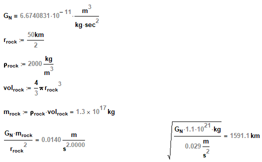

I also started punching these equations into Mathcad. Got some strange answers until I realized there is an environment variable setting the exponential threshold. Mine was set at ^15. Moved it to ^50 and suddenly it made sense again.
I haven't shown my son MathCAD yet. Not sure it would be a good idea to do so while he is still learning to handle units in equations etc.
