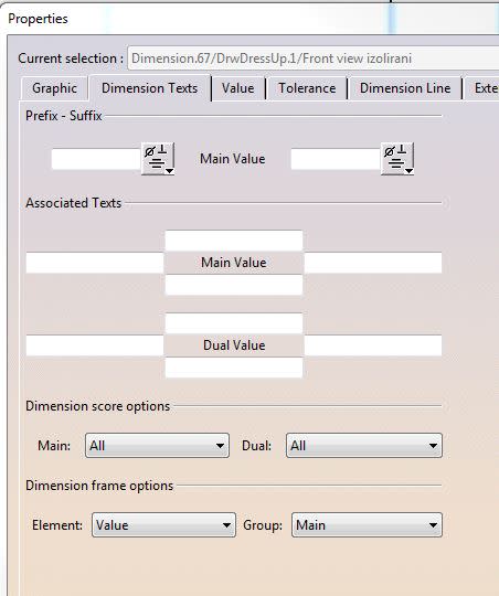

Is there a method to retrieve the dimension text position data? I failed to find the a way to do it.
I intend to give number 001,002...to all the dimensions automatically. This number text is placed nearby the dimension text.

You could add text [001,002,... ] to Value with "SetPSText" or SetBaultText". Then the position of text does not matter.

what i want to do is to give numbering to all the dimensions in the sheet from 1 to n, the number supposed nearby the dimension text. So i need to get the dimension text position.

I think what Romaleee is referring to are the "Insert text before" and "Insert text after" manipulators

It's exactly like Lwolf said. You can add text with code in this fields...
With this your text will always stick with dimension value.

CODE --> vba
Dim oDim As DrawingDimension
Set oDim = drawingDimensions1.Item("Dimension.1")
Dim oValue As DrawingDimValue
Set oValue = oDim.GetValue
oValue.SetBaultText 1, "before - ", " - after", "upper", "lower"
