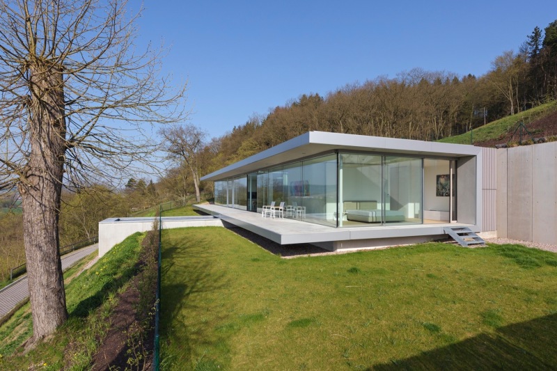

Hi guys,
An architect is doing remodeling for a house on a hill (high seismicity region on sloped soil) and wants to place a cantilever pool (see attachment). Width is ~3.5 m, depth ~2.0 m, length pending.
Considering the house and terrace are already there, meaning this pool would not be monolithic with the rest of the structure, do you see this project reasonably possible?
I'm thinking the main problem is stability and constructibility. I was thinking maybe anchor bolts to the ground (dywidag or similar) may solve the problem but I don't know the practicality of such solution. Another approach would be a big foundation below the pool but my numbers tell me it would need to be huge.
Since the length is pending the most obvious solution would be to choose one with a cantilever that doesn't lead to a stability problem. This seems the obvious thing to do since at first sight the photo seems something not achievable, yet the problem is it deviates from what the architect wants.
Do you have any thoughts on this?
Kind regards.

Just eyeballing it......it doesn't appear it goes very deep into the terrace. So I'm not sure if you have the room for the option I am thinking of: a micro pile pile group (with some of them at angles) with a reinforced concrete cap on top that the end of your pool could tie into. That's about the only arrangement I can think of that is going to give you vertical and rotational stability at that end. (And not have the typical vibration issues of pile driving.)

My first thought is that the renovation has to include work on the interior at the lower level: cut through the slab and excavate so that you can pour a back span to the cantilevered sides of the pool. That can all be patched back up and put back together.
RE: Cantilever pool for a house
I vote for an "L" shaped support underground with a footing or pile centered under the c.g. of the pool. The vertical and horizontal leg of the "L" must be designed to resist the required moment, but the footing is centrally loaded.

That isn't so crazy. When I was a kid back in the 1960's I saw a show about a house up on Mulholland drive in LA that had a pool that rotated up out of the floor and into the wall to convert the space into a tennis court. As you have it drawn you should be able to get the required strength out of the side walls of the pool. You will need to be very careful with the bearing pressure at the top of the slope because you could easily get into a slope stability issue. And as kipfoot said, extend the pool walls back into the basement to pick up back-span leverage and dead loads from the rest of the structure. Would it be easy? NO. Would my fee be high? You bet!

Low seismic, maybe. High seismic, maybe not... I can see the channel shape going into a torsional mode in the event of a serious event. You would have to make some sort of tube out of it for it to maybe work... and that' s assuming the back span can be made fairly rigid. You may be able to use part of the tube as a walkway around the pool.

Can it be done as drawn as a retrofit - Not within anyones reasonable budget. Far too much piling / excavation.
Something like though might be feasible and wouldn't spoil the view from the pool. Still quite a structure to lock in place.

IRstuff, that image is very deceiving.
See this one of the same house:

The attached file illustrates two concepts which could be considered. The first is a double cantilevered pool which the architect may not like but which makes sense structurally. The second is a singly cantilevered pool which requires a well reinforced "L" shaped structure below grade. I have used this concept on a lighter structure. The pressure on the footing is virtually the same for the two schemes but the pool walls and the "L" shape require plenty of reinforcement.

There is no debate this would be prohibitive in costs, and also being a high seismicity zone with a steep slope I'm afraid local site amplification plus vertical, horizontal and torsional seismic demands would result in a monster structure . I would need a geotech to help me for stability, and engineering would be costly as well (lots of analyses I suppose). I would be even a bit scared to place my signature on this.
So I think I'll just call the architect and tell him it's not reasonably possible, and give him some alternatives. I bet he will ask me how come we can place people in the moon and can't build a simple cantilever pool. I still haven't thought the reply to this.
@Kootk, house doesn't have a basement, there are traditional foundations below the shear walls.
There is soil below but it appears to be very stiff.
@BAretired, I think what you proposed would be the way to go but still such a big substructure would result in stability issues for the steep slope, which would result in an even more costly work
