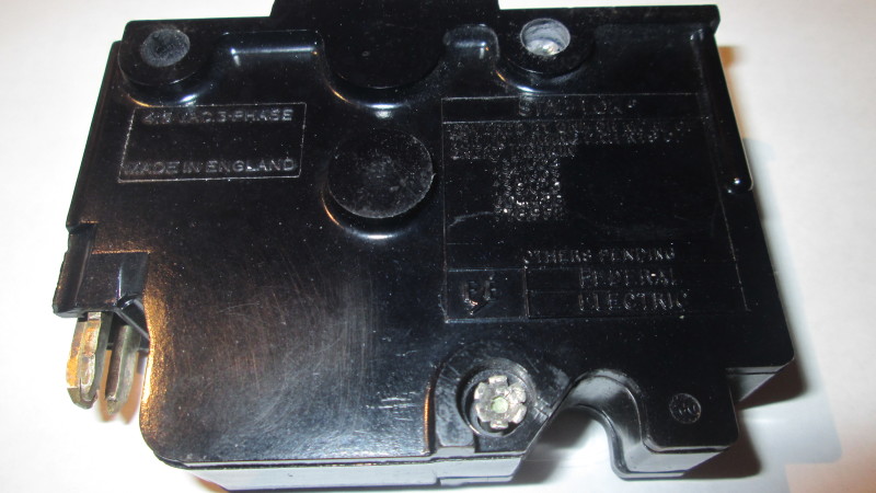

Federal Electric was a British company which appears to have been established to manufacture a home-market version of the Federal Pacific Stab-Lok miniature circuit breaker design built to the legacy BS3871 standard. Federal Electric are no longer trading.
We still have a fairly large population of early 1970's vintage Federal Electric breakers on site. I'm ultimately trying to replace these aging assets, but one of our inspectors has quite reasonably queried the breaking capacity of these early MCB's as we have some locations with higher-than-average prospective fault levels. Contemporary breakers have breaking capacities in the 1kA to 6kA range, but I'm struggling to find anything on the old Stab-Lok range. Has anyone got an old catalogue or old datasheet they could share?
I'm aware of the horror stories with the US-manufactured 2-pole devices not tripping, and I wonder if the problem extends to the 3-pole versions? There doesn't seem to be any discussion of that. FWIW, I think they're an awful design and I can well imagine that they do periodically catch fire in heavily loaded circuits.

These are a much, much earlier design. Black Bakelite housing, black toggle.

I've already reached the conclusion that the UK-manufactured breed of these boards are absolute crap: the breakers are crap, the busbar structure is crap, the main switch is crap and the enclosure is crap. I'm just struggling to find out whether I have a problem with inadequate breaking capacity on top of the fire risk and failure-to-trip problem. Unfortunately I'm going to have some of these on our system for a while longer and I'd like to more fully understand what risk I'm faced with.

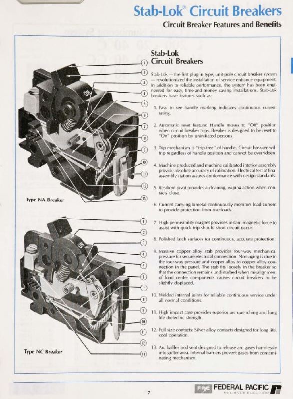

For anyone looking for information on the US versions, here's a couple extracts from vintage catalogues:
http://files.engineering.com/getfile.aspx?folder=9...
http://files.engineering.com/getfile.aspx?folder=4...

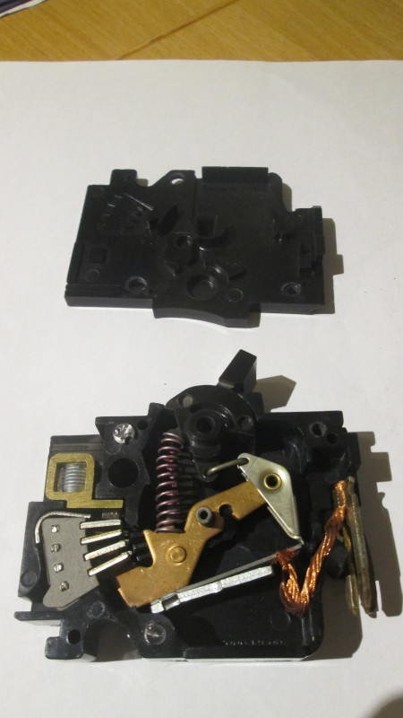

The British variant has a slightly different moulded housing but the main features of the US design are all visible. I'm going to dismantle one of ours and compare its internals with the sectional drawing in the second link.

Thank you for posting those, I've been looking for an old FPE catalog! :)
Drill a few open and post pics. They might be different they might not be. I think that will be the ultimate tell.

I'll pick a couple of MCB's up next time I'm at site and open them up at home. Far too many hoops to jump through for Engineering to be allowed to use the pedestal drill in the workshop...

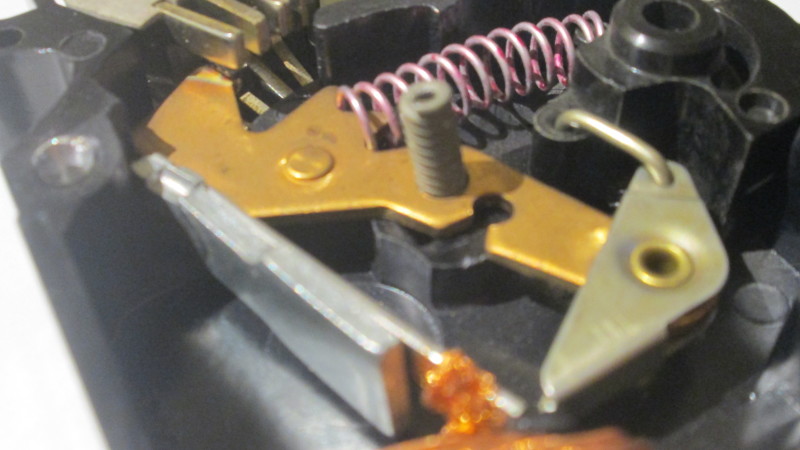

Well, I have opened up one of the British-made breakers and it is remarkably close to the US design based on the sectional diagram.
The pivot made from a spring, the plug-in Stab-Lok connector, and the trip mechanism are virtually identical to the US design. The arc chute is different.
The "high permeability magnet" - the silver strip attached to the bi-metal element - which is supposed to provide the high-speed trip in the event of a short circuit appears to have zero magnetism, although it is magnetic. I am not certain that this item should have any discernible magnetism, or whether it is simply a piece of steel or similar material which is magnetised by the magnetic field created by a short circuit. Any thoughts?

Looks like a near carbon copy of the US version. Only thing that looks different is the presence of an arc stretcher (forget the technical name atm lol) most likely to compensate interrupting an increased voltage across the contacts.
It could be magnetic or it could rely on induction from current flowing through the bimetal, but that makes little difference. (Have you tried to see if its magnetic on its own for the sake of it?) Because the magnetic pole piece does not move on its own and still requires the bimetal to bend it is nothing more than a gimmick and accidental short circuits by electricians in the US have demonstrated that. These breakers have no practical magnetic trip, certainly not the near instantaneous tripping seen with modern breakers. I don't know about the UK's codes back when these breakers were being installed, but I'd imagine today they would violate disconnect times under the modern BS7671. Remember that modern breakers have large solenoid coils independent of their thermal mechanism designed to trip at about 3-5x current for a "b" breaker, 5-10x for a type C and 10-20 for a type D. At minimum this would be a type D, though a rather generous type D in a wishful world.

The little strip itself isn't magnetised, but it is attracted by a magnet. Conclusion: it's probably a piece of mild steel. I can see how a sufficiently large current might induce some mutual attraction between it and the current-carrying bi-metal, but I can't imagine there being much force involved. If I get time I'll see if we can contrive some sort of test using the primary injection set and see what these actually do.
Most likely. Chances are very large current will induce force, and even if that force acts on the bi-metal in a downward pull, said bi-metal must still heat up first in order to bend back. You could call it magnetically assisted thermal tripping, assuming it makes a big enough difference to start with.

The bi-metal element is probably half iron and half something else - copper being the obvious candidate. From what I can observe of the mechanism, the steel strip is fairly rigid, and any magnetic interaction would tend to attract the bi-metal toward the steel strip, releasing the latch. It's tricky to simulate by hand because of the lack of mechanical support for the mechanism when the cover is split. I may drill a little hole so I can insert a pin to gently push the bi-metal toward the strip, just to see if my hypothesis is correct.
