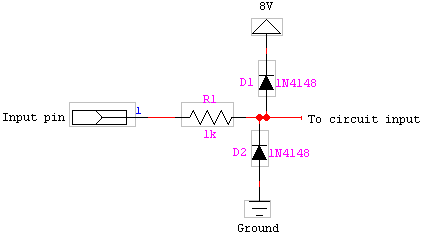

Nevertheless, my question is, can I simply include a 5V zener diode on the input to the ADC, so that any spikes above 5V would be clipped off?
It seems too simple a solution, so I'm guessing I can't do it?
Would it mess up the linear behaviour of the load cell output amplified signal?
If so, is there an easy way to provide protection for the ADC input?
It can only tolerate 5.5V

But, I certainly agree with using a diode from the input signal to the 5V rail. This will limit the input voltage to 5.7V which will likely not actually hurt the input. If you're chicken to do that then use a Schottky diode as they have only ~0.3V forward limiting the input to 5.3V. They can be slightly problematic since they leak reverse current which varies greatly with temperature.
This is sort what we're describing:

Regarding D2 in the image below, am I correct to presume it is an option?
I mean, am I correct to presume that D1 on its own, (along with the resistor), is adequate to protect against a positive voltage spike?
If I am wrong to think that, could someone please explain the function of D2.
I don't understand it.
RE: LIMIT ADC INPUT WITH ZENER DIODE ??
D2 is indeed for negative excursions. If you can have excessive positive spikes usually negative ones are also possible.
Most integrated semiconductor devices have protection diodes like the ones in the above circuit. Check the data sheets. If they are present then you don't need external ones as long as R1 (above) is large enough to limit the current to below what the internal diodes are rated for.

Since the positive spike I am predicting will happen, will in reality be as a result of excess load on the load cell, (beyond its planned window of operation), I suppose I am probably using the word "spike" incorrectly, as like you said, it suggests a negative spike might also be in the vicinity. I'm quite confident there won't be a negative spike since this signal is the output from my INA125 amplifier, and as I have it wired, it can't output a negative.
Your solution is a nice simple modification for me to add on, since the circuit is already finished.
It may well be that the excess load never happens, but its good to just make provision and forget about it.
