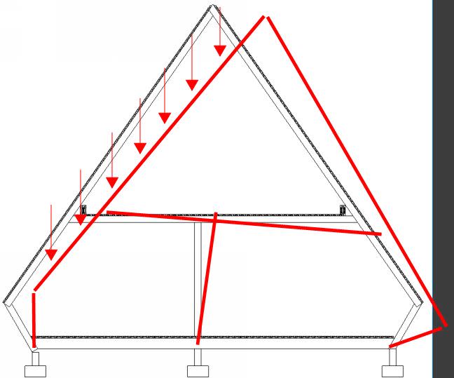

Could you get this to work?
This is an interesting one. Yesterday I was asked to look at a house built in the 1970's and have attached the basic frame section. The frames are constructed of 4x6 lumber @ 42" oc and 2x6 T&G decking for floors and roof. The loft floor stops about 10' from the front wall of the structure and there are interior walls in the plane of the frame at 10'-12' spacing. The longitudinal beams shown at the edge of the loft are (3) ply 2x10's with offset butt joints. I could not find any locations with 2 plies butted at the same location so I assume they are 16' long with 5'-4" offset.
RE: Could you get this to work?
It looks laterally unstable. Maybe the interior walls in the plane of the frame are acting as shear walls to provide the lateral support.
Looks like it shouldn't work... do you have any moment transfer at the haunch?
Dik
When I walked in my first thought was "What have I gotten myself into?" and 2nd "Maybe I should just leave". ;>)
Cal91. Yes, the interior walls are providing lateral support.
dik. I agree, it looks like it should not work but it has been there for 50 years. It was a windy day and I did not perceive any wind induced motion while upstairs. I also did some rhythmic bouncing and the loft was stiffer than the main level (and stiffer then most floors in my own house for that matter.
To answer your second question the connection at the loft/rafter does not have any moment capacity. in fact, I would say that it has limited gravity capacity. See attached photo.

Performance is an excellent indicator of success
ash060. It is pretty hard to tell someone that their home too unstable to stand when it has been continually lived in for nearly 50 years. Anyone care to comment on load path and joint free-body diagrams? I have my ideas but would like to hear what others come up with.
Assume that it is stable (given 50 year history).

Seems like you can't get around there being some moment fixity at the joints, particularly at the exterior foundation/exterior wall joint for this to be stable.
I disagree. I think the frame provides vertical stability without any moment connections. The frame is stabilized laterally by the roof diaphragm / interior shear walls.
It's analogous to a simple supported beam on two pinned columns is vertically stable, and laterally stabilized by diaphragm / lateral force resisting system.

In my opinion it is simply an A-frame, supported on the little struts, and stabilized by the walls/floor
The main rafters are bending at the loft connection, which ties each side together. (the photo you attached)
No. As currently drawn, the structure is unstable laterally.

It seems everyone is overthinking it. The basic frame with the rafters and bottom chord is obviously stable. The odd little splayed studs can't go left or right or both without bending the lower floor joists and bending the tails of the rafters. Provided that the bending resistance is there in the joists and in the rafter tails, pin joints everywhere in this arrangement are eminently stable, as has been demonstrated for 50 years. If you don't believe it, get out your popsicle sticks & try it.
I vote unstable save for the effect of interior and exterior shear walls. And I wouldn't be too thrilled about having my E&O insurance tethered to the thing unless I'd identified and evaluated those shear walls with some care. What's the issue that got you looking at this thing in the first place? Owner fishing for an open floor plan?
I suspect that the frame derives much of its gravity load "stability" from the fact that the gravity loads appear to be distributed pretty symmetrically.
My spidey senses lead me to speculate that something is missing from this picture though. If stability is really as fragile as it appears, I would have thought this thing pretty tough build in the first place without resorting to shoring etc.

Gravity stability - bending rafter tails
Lateral stability - floor and cross walls.
A trussed roof spanning between two side walls isn’t stable either without crosswalls. Are we going to fail that scenario too?

In the absence of moment connections, I disagree with the notion that the rafter tails in bending address gravity stability. Below, I've drawn a racking mechanism that involves no flexural deformation and no axial deformation (almost, more on that later). In my opinion, this serves as proof that the thing is unstable in the absence of shear walls etc as described above. And this is considering the rafter tails to be rigid. As anyone who's designed tail bearing trusses can attest to, the rafter tails are anything but rigid and often insufficiently strong. They're sketchy at the best of times.
There is a small flaw in my argument here. The mechanism below would require the middle post to shorten. I've shown that below, greatly exaggerated. So the frame would be stable mathematically if the collar ties were sufficient rigid flexurally. But, then, I can't fathom a structural engineer worthy of the title putting any serious stock in that.
I also contend that the situation is quite different from that of a common house truss on plumb walls. With plumb walls, unbalanced gravity load does not produce a significant tendency towards lateral movement (racking). That's a pretty fundamental difference. Just ask the steel erectors that work on the Frank Gehry stuff.

I think that I might know how this building is working. Given my assumption that it is not possible to make a moment connection in wood framing I started by visualizing the free body of the wall / rafter joint. In doing this I realized that in order for that joints forces to resolve, the rafter must be in tension, otherwise the wall is going to fall over.
Well, that realization put everything into a different light! Once I came to grips with that I started looking to see what could be holding this thing up. I think that the basic gravity load path is 3 bearing points, center wall and the 3-ply 2x10 beams that are place above the loft floor joist/rafter joint. This beam runs the full length of the building down both sides and passes through all of the partition walls. My theory is that these beams are bearing at the partition walls down to the floor structure. When looking at it this way the rafter tails have a little bit of axial tension and relatively small amount of bending with support at the end provided by the inclined wall.
Bingo! The owner is gonna love you. At least they should.
- There isn't a stability issue because the sloped walls aren't really load bearing.
- This nicely addresses the construction issue that tripped my spidey senses earlier.

Coming into this discussion a little late, but it appears the structure is not entirely symmetrical as the vertical wall appears to be slightly off center. Uniform load on the second floor would tend to cause the structure to move to the right.
I disagree that the rafter tails are in tension. They are primarily in bending, but slightly in compression. The short sloping walls are also in compression.
Without the benefit of shear walls, this structure is unstable.

BAretired. here is the free body. With only two members both of which are inclined the one must be in tension and the other in compression or the node will displace. Here is the simple diagram. If the tail is in compression (pushing towards the node) the wall will fall over.
Haydenwse,
You are assuming a hinge in the rafter at the junction to second floor. Actually, the rafter is continuous. If the sloping wall is removed, the rafter would be a cantilever which would deflect downward. The sloping wall prevents that, so the sloping wall is in compression. That compression can be resolved into components parallel and perpendicular to the rafter. One causes axial compression while the other causes bending in the rafter tail.
It is possible that the 3-2x10 beams carry some of the second floor load into the partitions as you have suggested but I don't know how much roof load they could carry. That would depend on their connection to the rafters which is not specified.
But whether or not the beams carry roof load into the partitions, the structure relies on the shear walls for lateral stability.

The typical rafter to beam connection in your latest photo seems to be fairly substantial, so I would agree with your
earlier suggestion that the longitudinal beams are probably transferring most of the roof and floor load to the partitions.
Presumably there is a column in each partition under each beam, possibly a triple stud.
The partitions are still acting as shear walls and, even if they are not lined with plywood, should still be adequate
with drywall properly fastened on each side.
