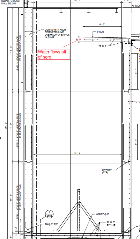

Does anyone have a company they have had good experience with that specializes in relining sumps/tanks? I have a proposal from a vendor to reline them with 316L SS. They are 30’ D x 47’ W x 13.75’ L (5 total). The cost is quite high, so hoping to find an alternative vendors to bid.

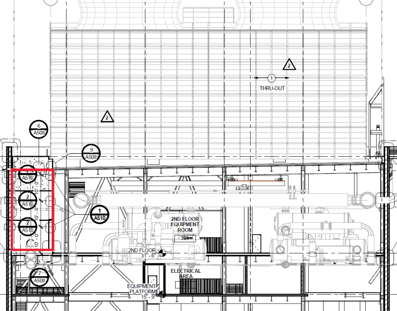

It is a cooling tower that is used to remove heat from four 8000 ton chiller units. It is water with standard cooling tower chemical treatment (biocide, pH adjustment, etc.). The temp is slightly higher than atmospheric.
The existing material is a rubber lining applied with adhesive. There are also angle iron strips bolted into the concrete walls that hold it on.
It has been a major hassle since very early on. Multiple repairs have been made, but leakage remains to be an issue. We suspect that the design of the cooling tower basin is partially the problem. The water runs down the basin and drops into these sumps. The velocity of the water is much higher than what the design firm was expecting, so it hits the northern wall (we experience leaks at both the north and south walls). Due to the cost involved to date, SS seems like it may be a viable option to prevent further issues (along with a baffle to stop water from hitting the wall). Nobody in upper management has confidence that an applied coating (spray on, adhesive, etc.) will prevent us from continuing the problem.

We typically maintain 10-13 feet of water in the sumps. We have no issues with cavitation. Many of the leaks are above the water line. While hurricane Harvey came through and dumped all that rain, the leakage observed through the weep holes increased, so rain water intrusion seems to be an issue as well. To date, nobody has been able to determine where rain water could be getting behind the liner.
