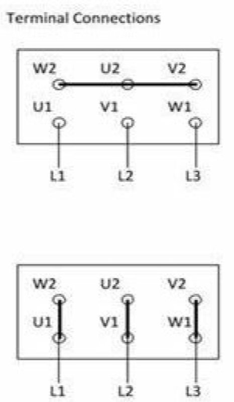

See if the winding star point is accessible. You probably need to remove the endbells to find it, or it may be buried. That 380/440V star winding would make a 220/250V delta winding which would work perfectly with the phase converter you've got.

I think the nameplate shows a 'Y' after the voltages - maybe Keith can confirm. A delta on such small motor would be quite unusual in my experience.

Scotty.. This picture is cast into the pecker head cover:
And... It is wired as DELTA now - The bottom diagram.
Does this mean the motor is actually:
440Y 220D @ 60Hz
and
380Y 190D @ 50Hz
or do I have it wrong.(?) How is it 220D/250Dv?

Neither. Wye/Delta voltages are always a factor sqrt(3) Never anything else.

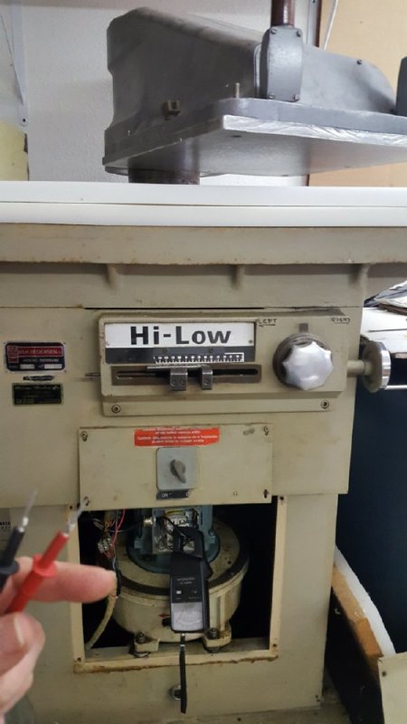

I'll be revisiting the thing tomorrow and will megger the three windings to each other and to the case and will also measure the winding resistances to see that they match.
I'll also (hopefully it with start) watch the starting current over the extended 6 second wind-up. Seems there is a massive flywheel running the pump which probably caused the long startup. The machine cycles pretty fast so maybe they use a smaller motor and store KE between punches.
If the measurements look good and connections tight I'll declare it mechanical and have a hydraulics servicing guy come by and drain the "lake" and check the intakes and any filters.
I don't actually know what a clogged inlet on, say, a gear pump does to the motor load. A centrifugal pump would likely unload with a clogged inlet (and cavitate like mad) but a hydraulic pump??
Here's a picture for you folks to chew on. You can see part of the little window I mentioned into the rotor just behind my clamp-on.
Oh, and you can see a site-glass into The Lake just below the opening into the machine.
