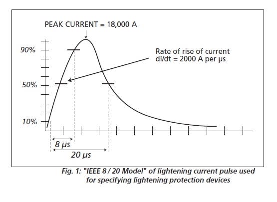

For purposes of understanding lightning behavior, it’s analysis and for specifying lightning protection devices, a common model of the lightning pulse has been specified by the Institute of Electrical and Electronics Engineers (IEEE). This model of the pulse is called the “The IEEE 8 / 20 Model” and is commonly used in specifying lightning protection devices. Figure 1 shows the current versus time graph of the pulse. It is generally thought
that this model is equal to or greater than 50% of lightning events. But, it should be remembered that the other half are more powerful than this
model predicts!
http://www.samlexamerica.com/support/documents/130...
In the class, I took at U of I, we used the 8/20 IEEE model. I don't know what the peak should be. The calcs are not too difficult and I posted examples below. In the class, we were modeling the lightning to determine what the grounding impedance would have to be so that you didn't have flashover when the lightning strike bounced off the ground and flashed over on the way back up, voltage doubling. You want your grounding wire to be as short as possible and for the connection to ground to be low impedance so that doesn't happen.
