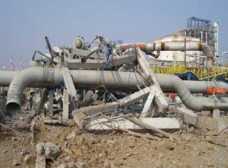

Remember, the MBAs, project managers and PMPs NEVER TAKE ANY RESPONSIBILITY if something goes wrong and people get hurt. If the test is successful and there are cost or schedule time savings....it is because of their superb management skills ..... if people die, well, its because of engineering incompetence
Pnuematic testing stores an incredible amount of energy in the system !!!
https://www.engineering.com/DesignerEdge/DesignerE...
http://www.eng-tips.com/viewthread.cfm?qid=352388
Wisely, ABSA has written a procedure on when and if this type of testing is acceptable. Large responsible organizations do this kind of thing .... Sloppy, b*tthole organizations, run by arrogant over-caffinated MBAs, do not
http://www.absa.ca/wp-content/uploads/2015/04/AB-5...
