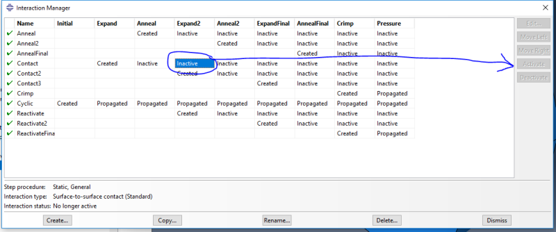

As far as the model change definitions - it appears that after an anneal step I cannot simply reactivate as it would seem. The box on the bottom left of the interaction for "activate in this step" is grayed-out, not letting me select it. Also, It looks to me that if I deactivate any interaction, I am not allowed to reactivate it if I "miss" a step. That's why my work-around was to redefine multiple contact interactions. I assumed what you mentioned should be the most efficient method, and it seemed odd to me that I wasn't "allowed". I'm sure it's because I'm not doing the correct order of operations. My work-around is clunky, but it seemed to actually work - for now.

you misunderstood me - you don't make changes in the Interaction Manager. You edit the interactions themselves. You should have one interaction for your model change (anneal), one for contact with the expander and one for your contact with the crimper. When you double click on each interaction in the Interaction Manager, you should open an "Edit Interaction" dialog box.
For the model change (anneal) you use the options "Deactivate in this step" and "Reactivate in this step" to control the activation/deactivation of elements throughout the entire analysis. So for each anneal step you would tick "Deactiate in this step". Then for the following Expansion step you would tick "Reactivate for this step". The interaction remains active throughout the entire analysis and should show as "modified" in the Interaction Manager.
Similarly, for the expander contact, you should open the "Edit Interaction" dialog box. In the bottom left is a box you can tick "Active in this step" that you use to control the activation/deactivation of the contact constraint during the anneal steps. So for each anneal step you would untick "Active in this step". Then for the following Expansion step you would tick "Active in this step". The interaction remains active throughout the analysis and should show as "modified" in the Interaction Manager.
