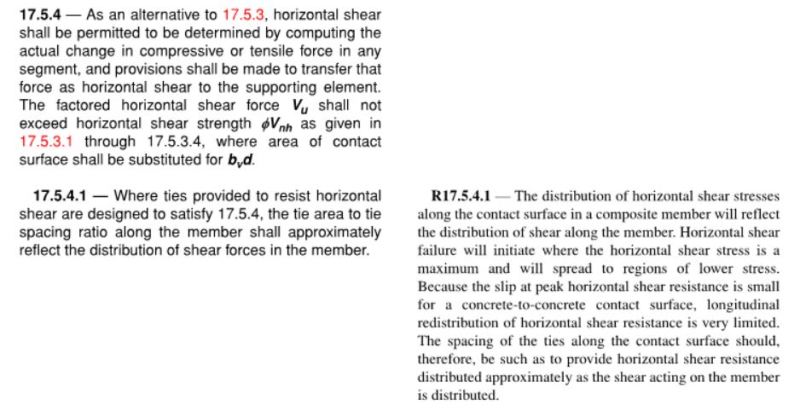

I'm tinkering with some precast hollow core plank that has a 3" structural topping and is working pretty hard. My software reports that horizontal shear at the plank to topping interface is a problem. And, practically, there really aren't a lot of good options for remedying the situation. Reinforcement would be ridiculous in a dry cast system and changing system depth would be a disaster for the project at this stage.
So, out of desperation, I cracked open ACI to give it a go by hand. The related provisions are shown below. 17.5.4.1, meant for when you have ties, suggests that horizontal shear capacity should correspond to peak shear demand rather than averaged shear demand (composite steel) because redistribution potential is limited. There's also similar language in the old PCI Hollow Core Manual. By that standard, my hand calcs agree with my software output and I've got problems.
But wait! If you check out 17.5.4, it gives you an alternate method. And that one works for me. However, is the alternate method not essentially saying that I can average my horizontal shear demand? If that's not the case then I really don't know how to apply 17.5.4.
For what it' worth, my loading is dominated by two, equal, point loads located at about 0.4L & 0.6L. So my shear diagram is pretty flat and my moment diagram is pretty close to a perfect trapezoid. I've been attempting to apply the alternate method over a "segment" that I've delineated as the span from the end of the plank to the first point load.

Was there a definition or limit on the "segment" in ACI?
lol - "my segment is 1/2 the span!!! Take that ACI!!!"
RE: Horizontal Shear in Composite Concrete Members Per ACI - Mixed Messages?
Quote (JAE)
Not that I could find. They seem to be relying on conventional English which is surely ill advised.
Quote (JAE)
Yeah, precisely. Nothing to prevent that interpretation as far as I can see.

ACI 318-14 is worded a little differently and references all locations for comparison.
16.4.5.1 As an alternative to 16.4.3.1, factored horizontal shear Vuh shall be calculated from the change in flexural compressive or tensile force in any segment of the composite concrete member, and Eq. (16.4.5.1) shall be satisfied at all locations along the contact surface:
φVnh ≥ Vuh (16.4.5.1)
Nominal horizontal shear strength Vnh shall be calculated in accordance with 16.4.4.1 or 16.4.4.2, where area of contact surface shall be substituted for bvd and Vuh shall be substituted for Vu. Provisions shall be made to transfer the change in compressive or tensile force as horizontal shear force across the interface.
Thanks for that haynewp. I'm still perplexed though. Consider:
1) The bit about satisfaction at all locations does make things sound less pro-averaging.
2) If bv x d is still being swapped out for the segment contact area, that still sounds like averaging to me.
3) Still really no definition regarding what an appropriate "segment" might be.
4) If the provision no longer allows for averaging, I don't see how the alternative method is really any different from the regular, peak stress method.
There's a distinct lack of clarity of intent on this one. Maybe this section is being stick handled by a summer intern or something.

Regarding the 2 different ACI methods, it appears there is a diffeence in what is being compared. The first is Vu and the second is Vuh, the shear flow at the location of the horizontal plane being considered is the way I read it.
16.4.3.1 Design strength for horizontal shear transfer shall satisfy Eq. (16.4.3.1) at all locations along the contact surface in a composite concrete flexural member, unless 16.4.5 is satisfied:
φVnh ≥ Vu (16.4.3.1) where nominal horizontal shear strength Vnh is calculated in

Quote (haynewp)
This speaks to the crux of my concern. I don't see that there is much difference. Vu is horizontal shear averaged over a length equal to the flexural depth. Vuh is horizontal shear averaged over some other "segment" length. If Vuh needs to effectively be Vu, then the methods are identical. If Vuh can be different, then it seems that larger scale averaging is implied to be acceptable.
If the segment length is taken as 0.4L, the shear span, would the shear capacity be adequate to carry the average shear in that length?

Regarding the ACI methods, the first, 17.5.3, calculates the horizontal interface shear force at each section of the beam which is taken equal to the average vertical shear on the section. Taking the average vertical shear (V/bd) accounts for non-linear redistribution at ultimate as apposed to the old linear elastic method (VQ/Ib) used for working loads.
The second method, 17.5.4, calculates the total shear force on the interface area. For a composite beam this shear force is due to the portion of axial compression component of the moment couple that has to be transferred into the deck/topping. The length of the interface is taken to be the distance from the point of zero moment where the axial compression transmitted is zero to the point of maximum moment where the transmitted compression peaks. For a simple span with a UDL this would be from the support to midspan. For dominant point loads it may be shorter (the shear span as BA says). The designer may also choose to design the interface for the axial capacity of the deck/topping instead of the actual shear load.
The second method, as far as I know, was developed for composite steel girders where there is sufficient slippage along the interface to mobilize all of the shear connectors equally. This doesn't happen with concrete on concrete which is why in the comments to 17.5.4 ACI says that any shear connectors should be distributed similar to the shear diagram which really takes you back to the first method. PCI and CPCI illustrates the second method in their design manuals but I think it's better suited to small interfaces like corbels or shear keys. In an unreinforced interface like hollowcore I'd be afraid that the relying on the second method could lead to a zipper failure. On the other hand I think topping failures on hollowcore are rare, though most would be uniformly loaded.
Quote (BAret)
It would and that's the route that I took. It's interesting. Zoomed out, the moment diagram looks quite tri-linear. Zoomed in, the slope of the moment diagram at the very end is clearly about 15% steeper than the "average over the segment". Presumably, that's the source of my difficulties.
