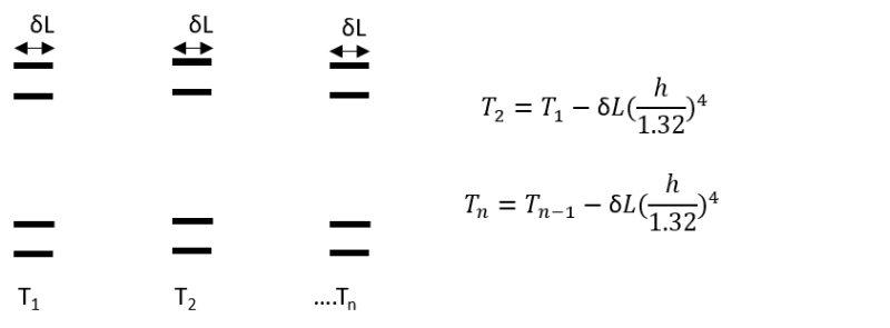

I'm trying to work out a formula for calculating the heat loss of hot air flowing through a pipe in cold air, so that eventually I can spec the length of pipe needed.
It's been a while since I'v done any thermodynamics so some help would really be appreciated. I've summarised the problem in the image bellow.

I've been looking at a few things but have been confused about the effect of the moving fluid through the pipe. I've found similar things to what you sent in your link, but will there be different effects because the fluid is moving through the pipe? My initial idea was to "slice up" the pipe and calculate the heat change iteratively for each section, but presumably the mass flow rate would have no effect on this? Or am I missing something?
I thought for these calculations I would assume wind speed=0 and calculate a worst case scenario.
It's for a exhaust filtering system where I need to cool exhaust gasses enough to be able to pass through a carbon filter.

"My initial idea was to "slice up" the pipe and calculate the heat change iteratively for each section, but presumably the mass flow rate would have no effect on this?"
cp*mass_flow*delta_T is the net heat flow in the pipe, so each increment chunk of the pipe must have the same relationship to account for the heat loss through the wall of the pipe.

Okay, sorry if I'm being stupid.
So from the equations for heat transfer coefficients from the link given in the first reply I get the equation bellow. How do I link that with cp*mass_flow*delta_T ?

The pipe runs through a section of open air (although it is shielded top and sides from wind) so we wanted to calculate if this section of pipe allows sufficient cooling so were going to use this calculation to evaluate that. I'd really appreciate some help with it, although I'm sure in the end a proper heat exchanger will be the best solution!

Just do it in energy
You should be able to get a heat flow rate in m2 and delta T. just chop you pipe into suitable sections, say 10m?
Then work out how much energy has left the pipe at some temperature ( estimate to start with)
Then work out what that energy means in terms of mass in that section. With flowrate you can work out the end temperature because you know the mass of air in that 10m section.
As I said you're trying to use steady state equations for a moving transient variable thing so you will need to do some iterations to get the numbers to work

For a straight pipe you use the log mean temperature difference. So the heat flux will work out to:
Q=h*A*((dti-dto)/ln(dti/dto))
where h is the combined heat transfer coefficient. If you got a steel pipe with no insulation then most of the resistance will be on the outside. Here its free convection that governs the equation. And free convection ALSO depends on the temperature so it becomes more tricky. I would try google "nusselt number natural convection horizontal cylinder calculator" and you could check this online calculator:
