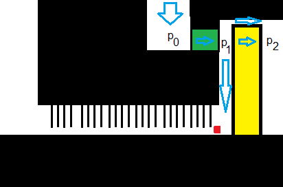

Yes, I have figured this part out that the pressure is the same after the nozzle and after the bucket (afterall, this is the theory behind impulse turbine) but currently I am looking for the pressure before the labyrinth. I used my magical MS Paint skills to draw a picture.
Yellow is the Curtis wheel, green is the nozzle, red is the spot I am interested in. If I assume v = 0 in that spot, should I have similar pressure as p2 (which is same as p1)?
So question in more simple form is, should I approximate the pressure in red spot to be same as it, or p0 - pressure loss from p1 to red due to high velocity? Or just assume that about all velocity is converted into heat so it would be isenthalpic process between p0 and red point, but pressure is same as p1?

The pressure and also BTU/lb at the red spot can be approximated with little error as P1. The P1 pressure will fill that entire cavity between the exit edge of nozzle and the rotor shaft with negligible variation for your purposes.
The flow will be determined by P1 / Pleakoff (assuming it goes to some other pressure controlled lined) and the flow coefficient of your packing.

Just ASSUMING here is that you have multiple packing with intermediate pressure between and not just a single shot like you shown of P1 down to Atmosphere. Pleakoff for a multistage turbine is tapped at a following stage to control the pressure and limit the amount of leakage flow. I havn't looked at a single stage in a long time but the last one I remember used a controlled line somewhere else in the plant to dump steam and control that flow. Your setup may be different and just use a much higher restriction (more teeth) to counter the higher driving force (more deltaP).
typical arrangement
Atmos 14.5 psia ~18psia Pleakoff (150 psia??) P1 (Nozzle exit press)
wwwwwwwwww wwwwwwwwww wwwwwwwww wwwwwwwwwww
